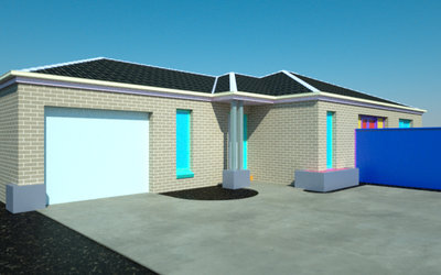

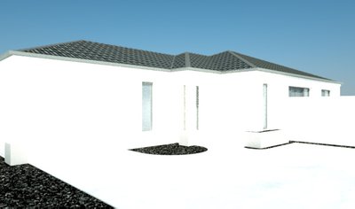

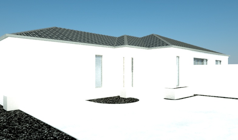

I am unable to get the 3ds Max plugin renders to look like the Standalone renders. Attached are 2 unfinished images but they show that the 3ds Max plugin renders are overexposed and totally desaturated. I have tried to copy the settings from Octane standalone. If I reduce the power of the sun the sky goes dark and the image is still desaturated. I have included the project files below.

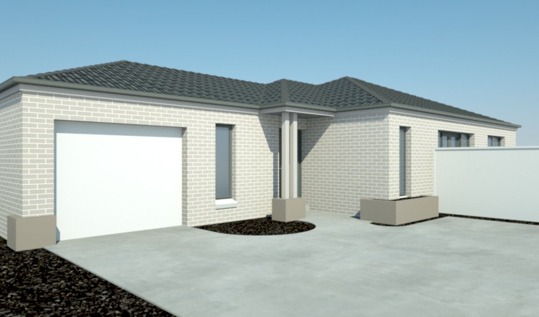

I´ll post a image of clone frome 3sec save.
Works same in normal render, my gamma might be off in Nvidia drivers settings (possible?), use it for interiour alot.

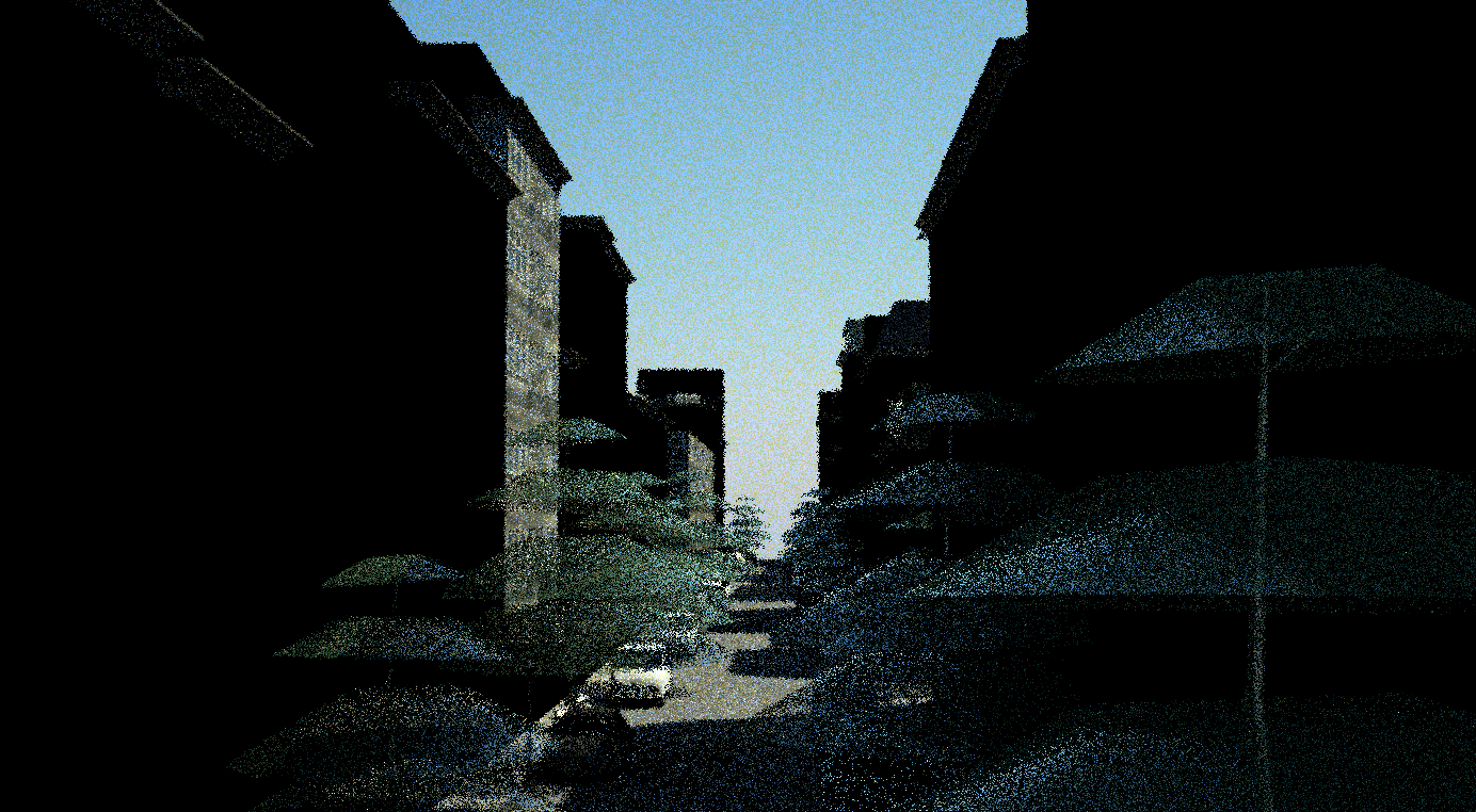

This is what happen when I restart realtime window on my limited vram scene.

Sauger, what did you change on my file to get the image to look like the one you posted? (realtime-octane ver.jpg) - yours looks much more correct.

I just hit "open octane render viewport", it´s wonderful when works like intended I know, and feel your frustration.
Are you on what ver of max?, Nvidia drivers, card so on, I do understand your frustration coming from a stable known world like standalone Octane ;)
