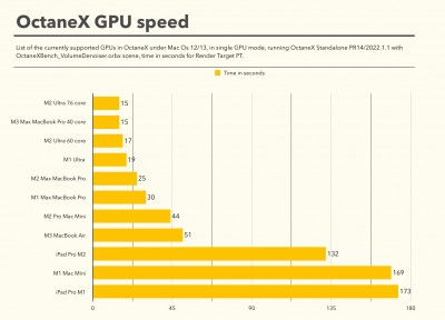

Hey all, is there anywhere I can see Octane Bench results for MacBook Pros running the base M3, vs the M3 Pro and Max?
I just bought an M3 MacBook Air for personal use (not rendering) but am wondering if I should return it and go for a MacBook Pro with the M3 Max chip. I'd then be able to use it for 3D work when I'm 'on the go'. I use a PC for my 3D work, with 2 x 3090s. I loaded a scene which takes 28 seconds for my PC to render a frame of... it took my M3 MacBook Air 44 minutes! So unless the M3 Max is vastly superior then I'd probably stick with the MacBook Air and rule out doing much/any 3D work on it. Thanks!
Posts: 10634
please follow this link and share your result with M3 base, and I'll update the chart.
viewtopic.php?f=7&t=75411&start=1320#p421617
M3 Max result is ~15".
Anyway, please consider that Apple Silicon is always slower in rendering, compared with CUDA, but it is faster in all the other tasks (eg AI Denoiser), and with 2024.1-Alpha versions you can use both 2x RTX 3090 via Net render.
viewtopic.php?f=7&t=75411&start=1580#p430565
ciao,
Beppe

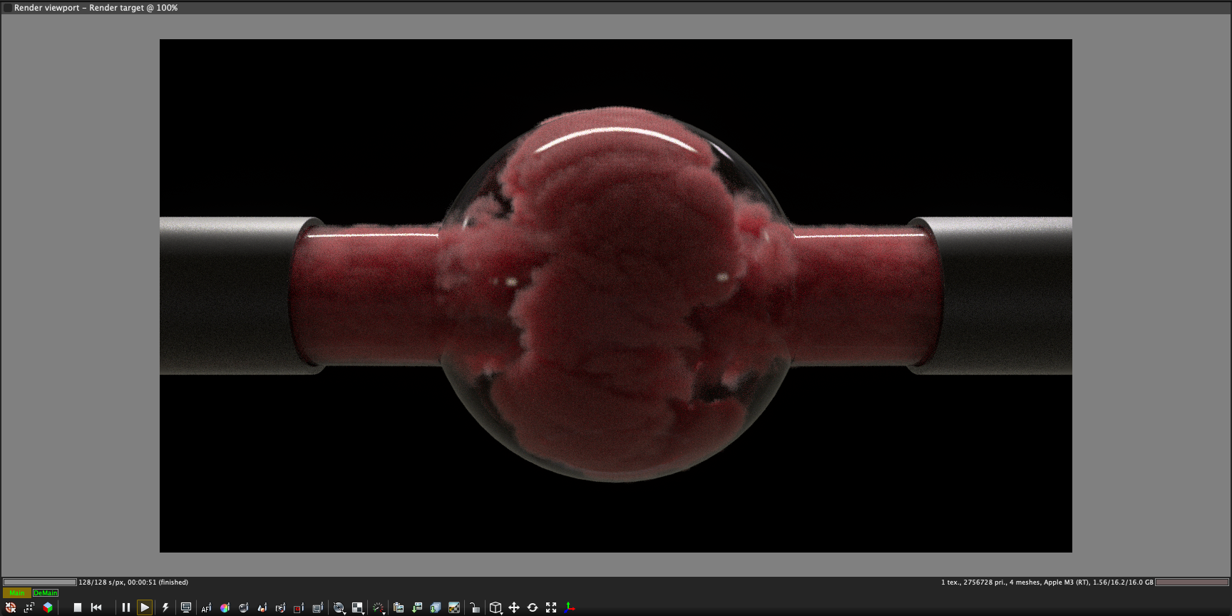

Thanks Beppe, here's my result with an M3 MacBook Air, 16GB - 51 seconds

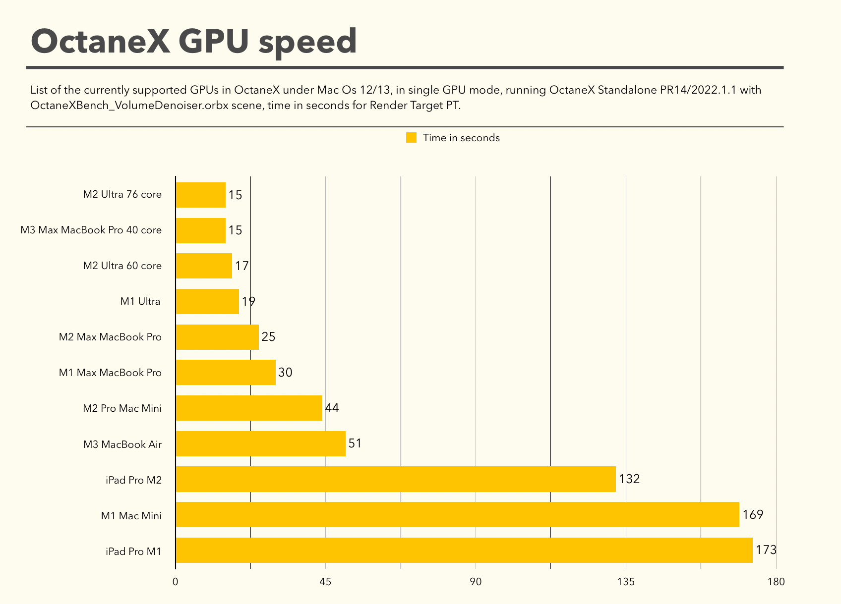

Posts: 10634
jc0 wrote:Thanks Beppe, here's my result with an M3 MacBook Air, 16GB - 51 seconds
Thanks!
Roughly more than 3x faster than M1 base!
Here is the updated chart:
ciao,
Beppe

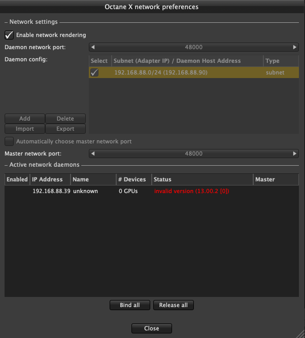

OK, found out I needed to have the 2024_Alpha_3 installed on the Mac.
Now I can open the network preferences but not sure what's wrong:
JoGo23
Posts: 55
Joined: Mon May 09, 2016 10:48 pm
You need to have the 2024_Alpha_3 on both sides.
