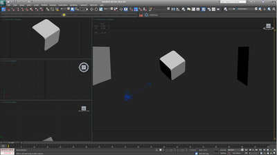

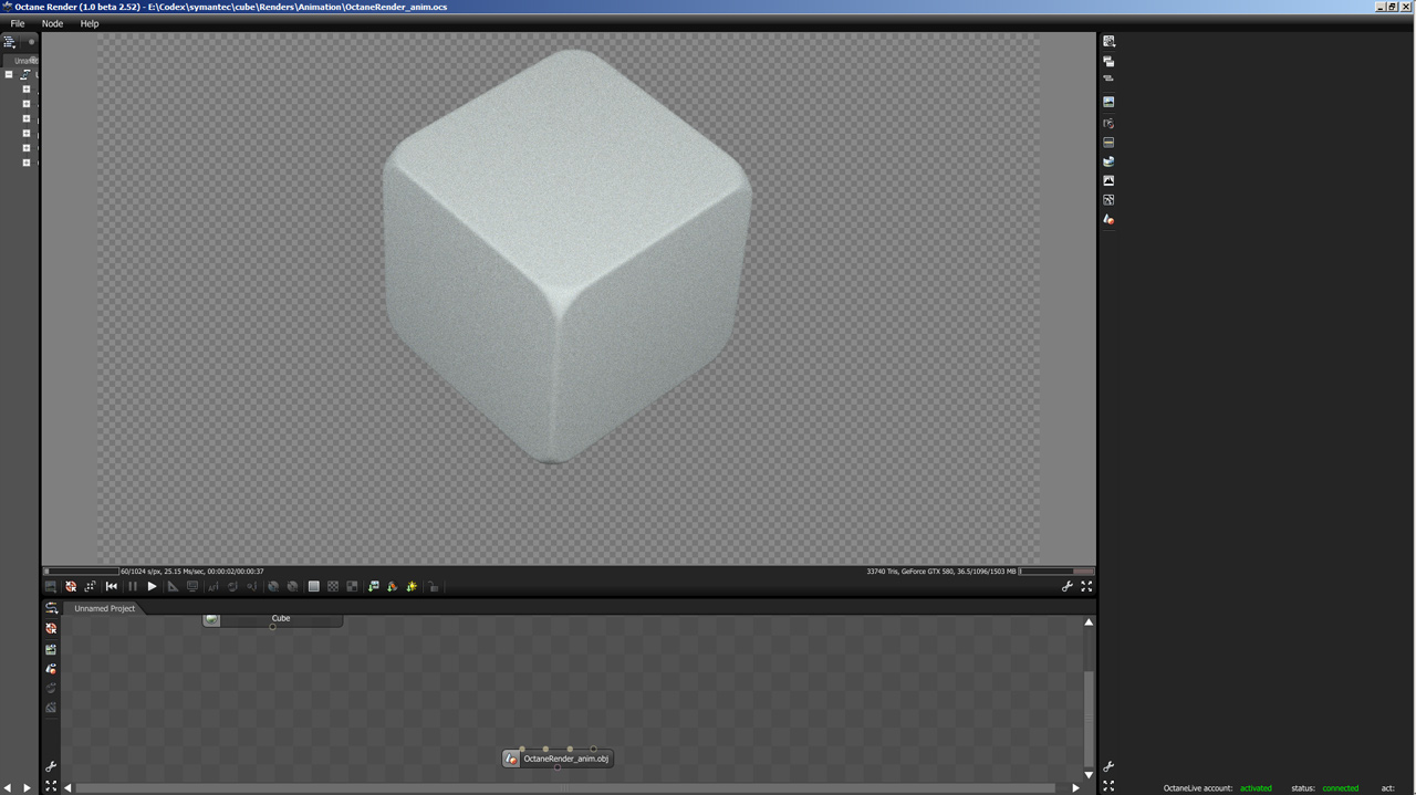

Here's some screengrabs.
Max window, then octane with the default auto-resizing setting at 0.025, then octane when I manually set the scale to 1.0
windows 7 64 bit| GTX580 1.5Gb x2 | Intel 2600k @ 4.9 | 16gb ddr3 | 3ds max 2012
