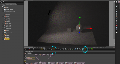

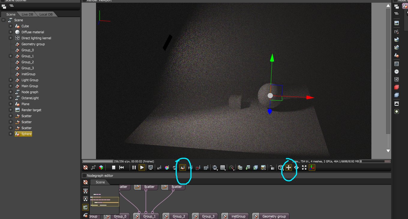

How do I move-rotate or scale Objects in the Viewport? can't figure it out as any object is exported in object layers and hard to crack down :/

justix wrote:How do I move-rotate or scale Objects in the Viewport? can't figure it out as any object is exported in object layers and hard to crack down :/
Use the "Object Picker" to select an object in the viewport and turn on the gizmo.
Thank you, I did but once is selected and I choose were the Gizmo is on Local or world I can't seem to do nothing as all commands on the mouse are for the camera..definitely need some docs

justix wrote:
try simple scene
