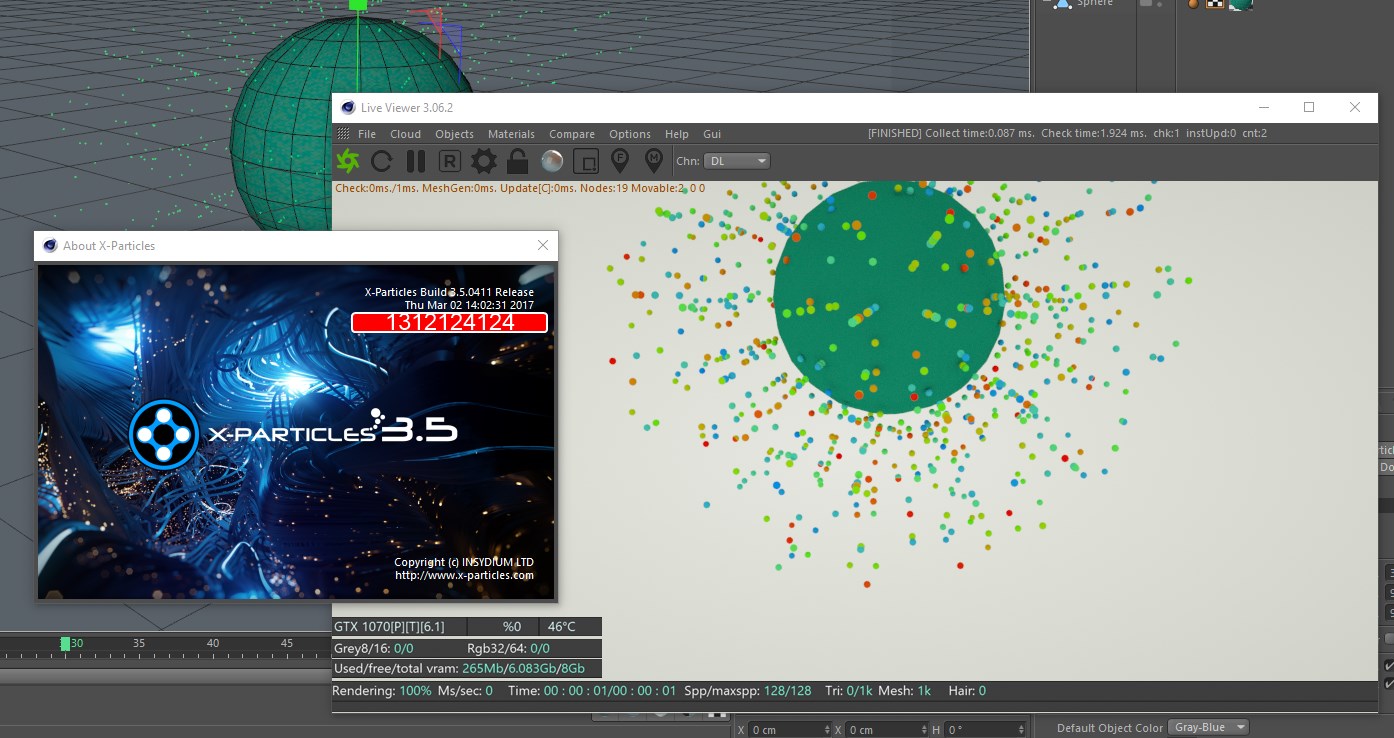

XPT is not rendered.
Something is wrong. There is no problem with 3.05.x

eyeonestudio wrote:XPT is not rendered.
xpt.zip
That seems to work ok here:
cheers
all OK

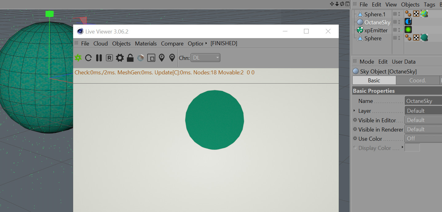

all OK
It is not rendered in the picture viewer. Is it just me? :D

artdude12
Posts: 85
Joined: Mon Feb 11, 2013 5:16 pm
Location: Chicago
It seems to render OK from the PV if I start with frame 1.
