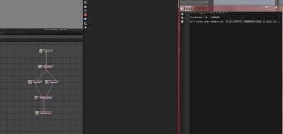

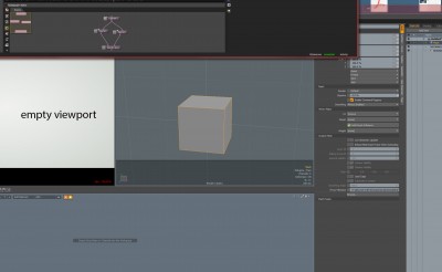

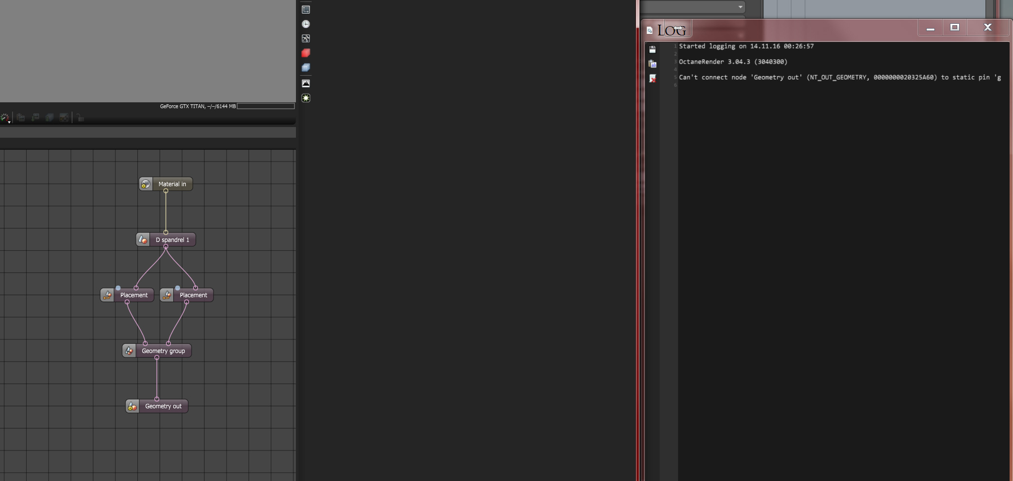

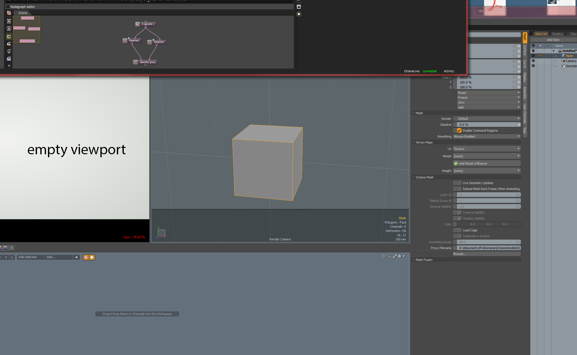

smicha
Posts: 3151
Location: Warsaw, Poland
Paul,
Thank you for help. So a render target node connected to a geometry group solves the problem (the "geometry out" node does not - shall it work ?) In error log I see that Octane cannot locate geometry out (although I placed it). If the render target is the only option to make it work it is fine. Would be great if also the "geometry out" node would work...
But as for the crash - I just tested it on 10.1 and 10.2 and 10.2 is not stable - whenever I move a mesh (W) modo crashes. Please find the commandlog attached.
commandLog1.txt
(527.67 KiB) Downloaded 310 times
Can you post a screenshot of the Octane Standalone node graph for the proxy OCS pls?

Nothing to apologize for, Paul. Fantastic support as always. The screenshot is attached.
face_off
Posts: 15822
Location: Adelaide, Australia
Thanks. There is a bug in how the Geometry Out node is connected into the scene graph. This is fixed in the next release.
Paul
