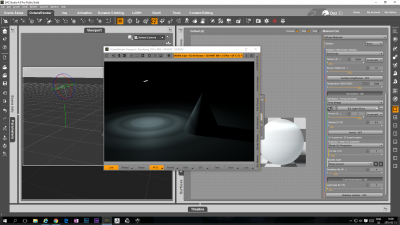

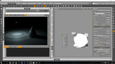

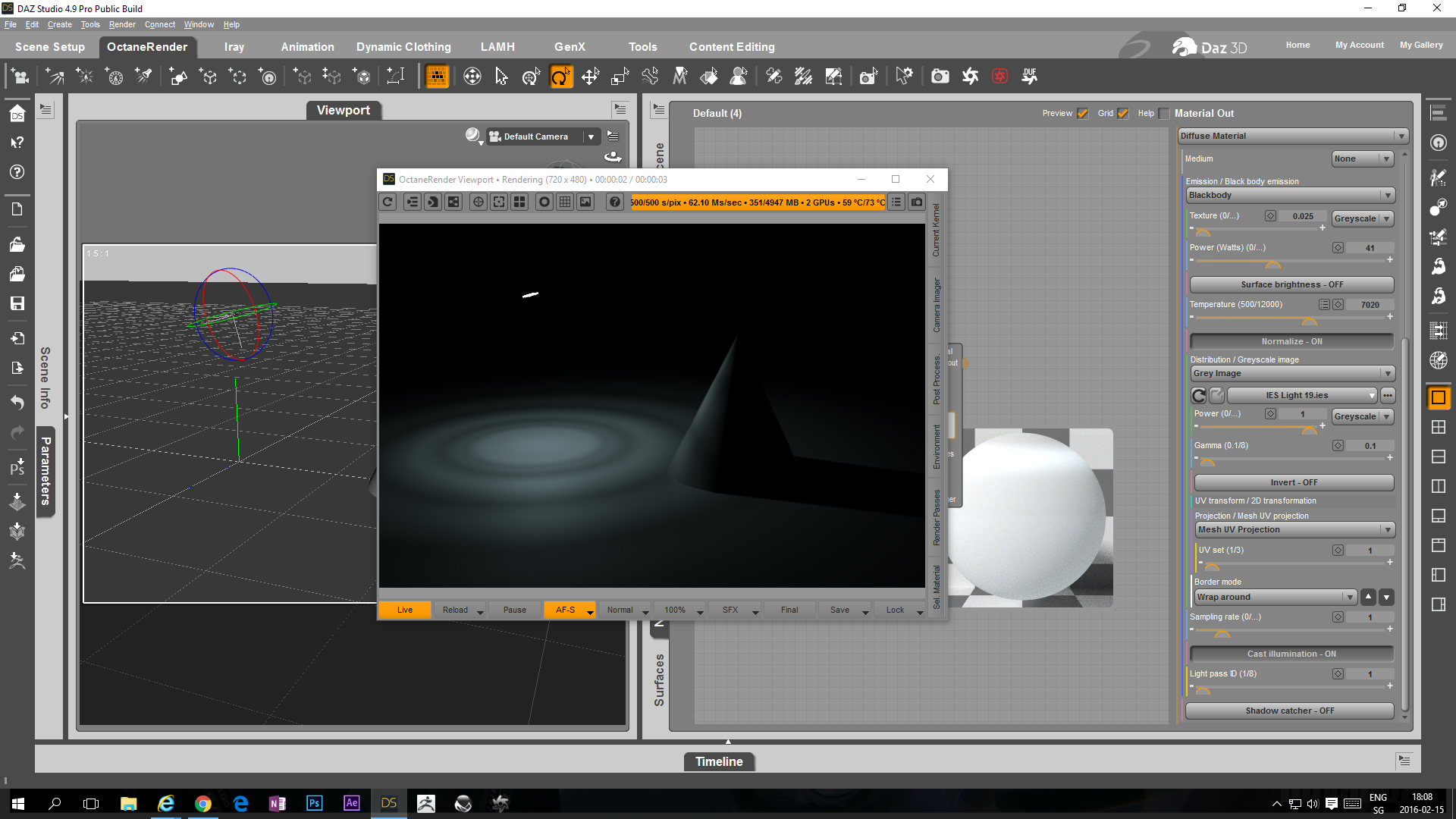

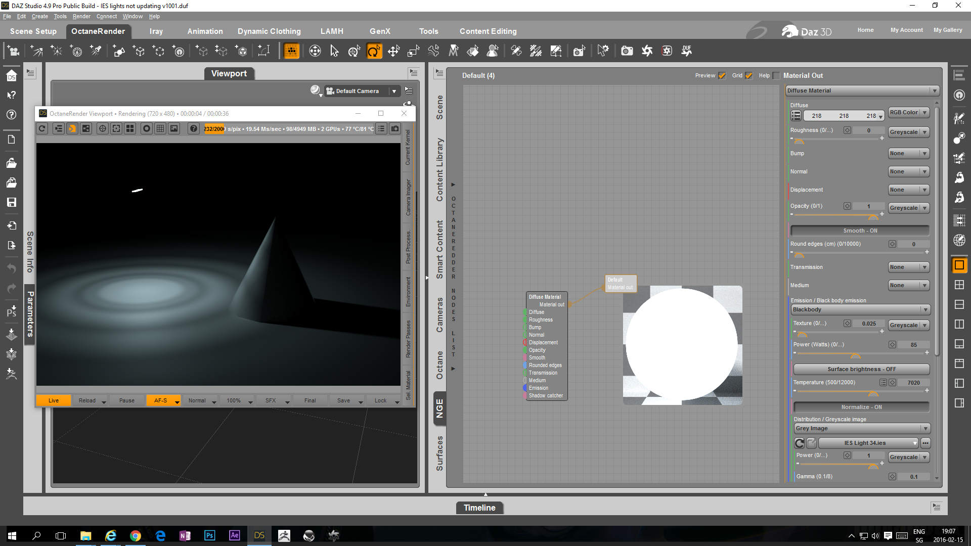

linvanchene
Posts: 783
Joined: Mon Mar 25, 2013 10:58 pm
Location: Switzerland
Low priority. Hard to track down
Happens randomly. No pattern detected:
Switching from one IES preset to another does not seem to update the viewport even with forced reload.
Update / Edit: This only seems to happen with some scenes.
Example:
- Test scene with IES 19 selected.
- Switch to IES 34
- viewport does not update.
- save scene
- reload scene
- IES 19 is still saved as preset even though it was changed to IES 34
Update / Edit:
When I try to reload this saved scene this not updating behaviour is the same.
Nevertheless when I create a new scene switching IES lights seems to work.
No clue why this is not working in that specific scene and is working in others.

face_off
Posts: 15811
Location: Adelaide, Australia
It looks like either the plugin is either not sending a "reload" msg to Octane when loading the new IES distribution, or the IES light is being loaded into an unused material and not the actual material being rendered. I will add this to the list of things to investigate.
