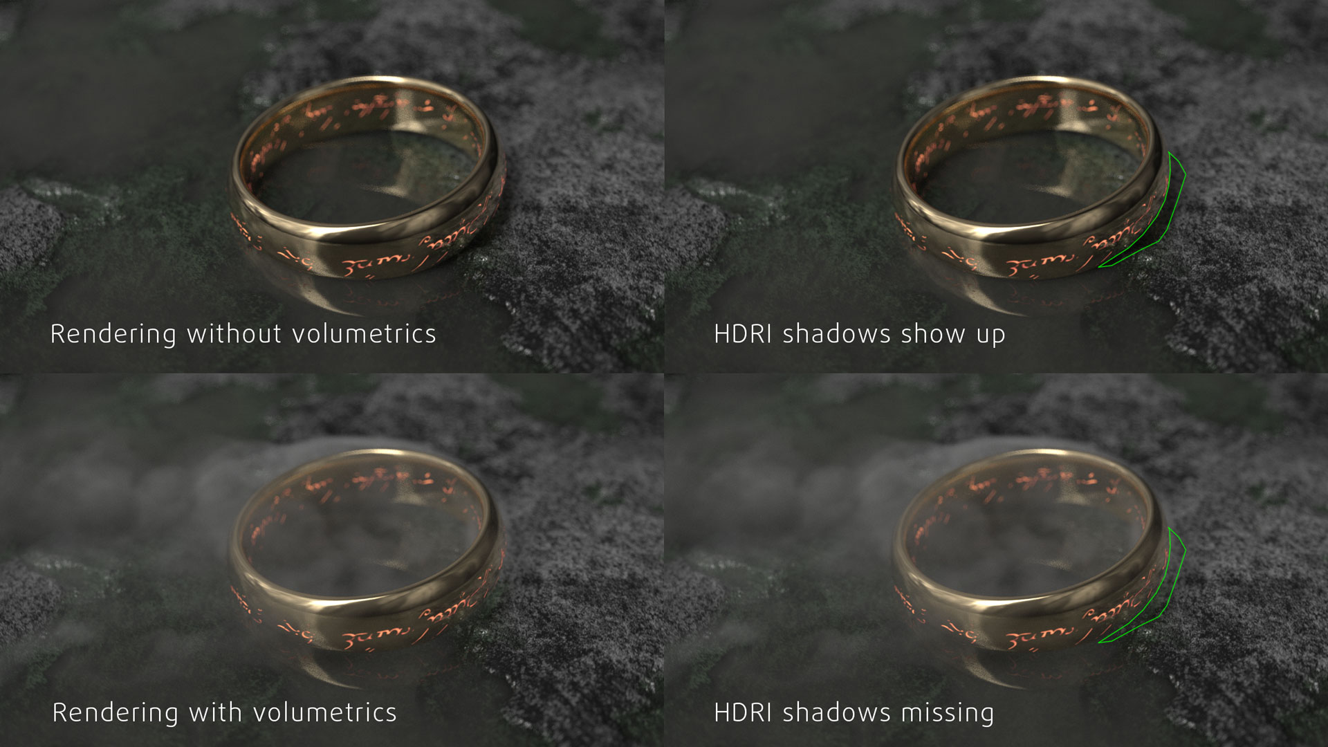

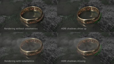

Hi there. I just wanted to let you know that I am running into the same problem.manalokos wrote:Volumes cause light to enter inside closed spaces.
I attached an image illustrating what happens inside a closed box when a volume intercepts the surface.
I know its being looked after. Just wanted to confirm that there is a problem with shadows!
