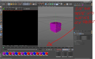

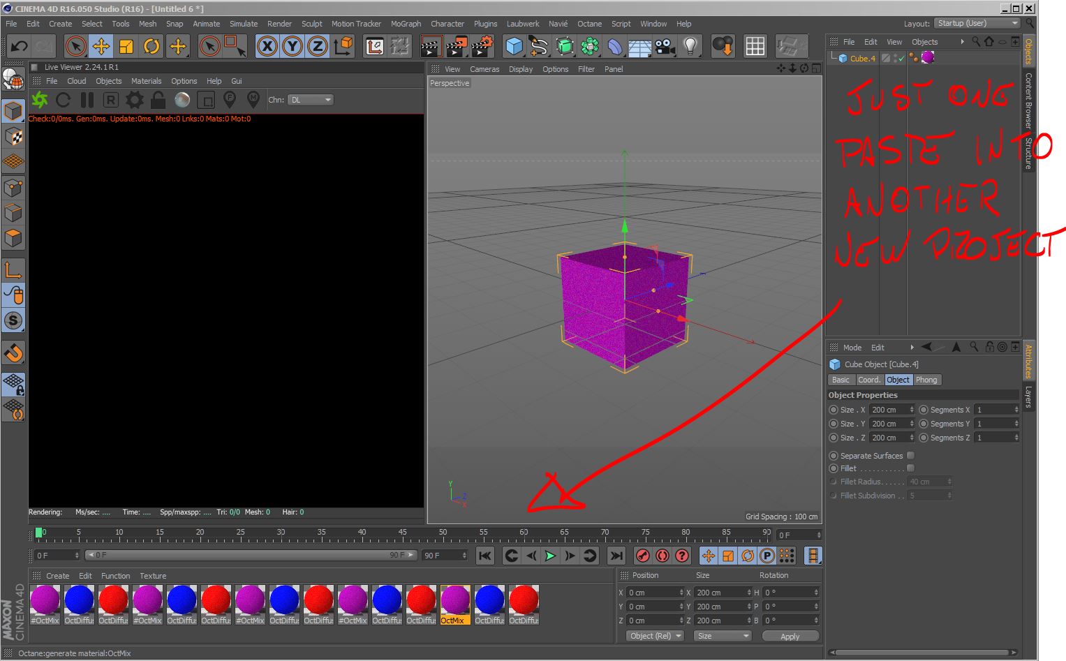

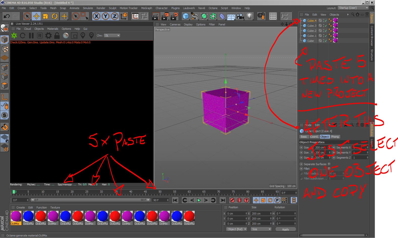

Other thing I notice is, every time I paste into a new project it creates another material for that object, but this is ok always happens, but the strange thing is if i select just one object of the ones I pasted make a copy and paste into a new project it paste the object, its material and all the other material pasted in the other project, I did some screen shots to explain better..

aqcoelho wrote:Other thing I notice is, every time I paste into a new project it creates another material for that object, but this is ok always happens, but the strange thing is if i select just one object of the ones I pasted make a copy and paste into a new project it paste the object, its material and all the other material pasted in the other project, I did some screen shots to explain better..
Thanks. I see. But solution can't be so simple as you could imagined. I found why happens but it can corrupt the some systems which i built over many things.
EDIT: I think that catched somethings about this. There is one mistake on me and plus a mysterious behaviour on mix material. I'll try to understand and fix.
I also had the same problem with Mix material, I have find a several copy of Mix material on another opened file where there isn't the object where I have applied Mix material
