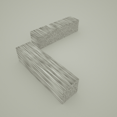

I have a question regarding the procedural maps like the turbulence texture. Is there no way to switch to local object coordinates instead of world? Or even better to control it with uvw mapping. Am I missing something?
The example shows two boxes, one is rotated 90 degrees, same material applied. In architectural renderings the direction of the texture often plays an important role. My only idea making the two boxes identical in this example is using 2 materials with different (swapped) transform values of the turbulence texture, which will result in more work while fine tuning the material(s).
Any help appreciated.
boris
boris

Unfortunately there is no way to avoid it at the moment.boris wrote:hi karba
boris
edit: seems other people have the same thoughts:
http://render.otoy.com/forum/viewtopic.php?f=27&t=33614
