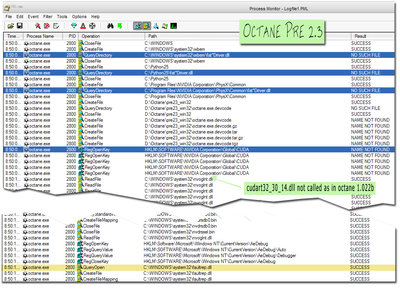

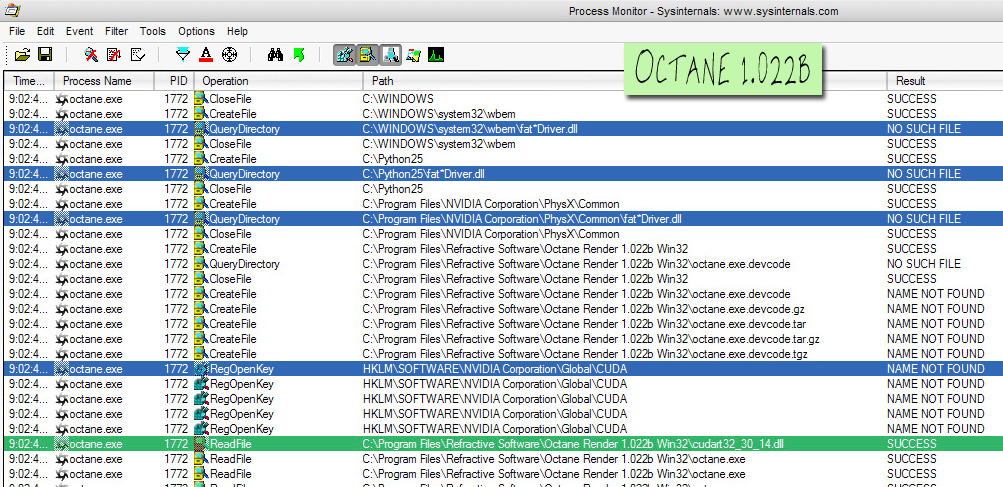

I've got the same problem as most people with Octane crashing in Win XP 32 bit. I've tried this under
Cuda 3.0 / Driver 197.13 and also Cuda 3.1.1 Driver 258.96 and the result is the same.
I Use the standard Blender cube and export it to "D:\". Click on add mesh, then select cube.obj. Sometimes the rendering will begin and sometimes not. On a lot of the crashes, octane was looking through all the environment variables for a file "fat*Driver.dll". See the following dump from Sysinternal process monitor at the time of crash.

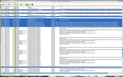

Well this may or may not help in finding the crash. As both Octane 1.022b and Pre 2.3 try to find a global file "fat*Drive.dll", its not the problem.
The following however may help: The difference between Pre 2.3 and 1.022b takes place after octane tries to access
HKLM\SOFTWARE\NVIDIA Corporation\Global\CUDA. Octane 1.022b goes on to access cudart32_30_14.dll whereas Pre2.3 does not. Pre2.3 does a few more things then proceeds to crash with the fault report and Dr. Watson while 1.022b happily continues.
The following attachments shows the difference of the processes when opening and clicking a material node in Pre2.3 and 1.022b
