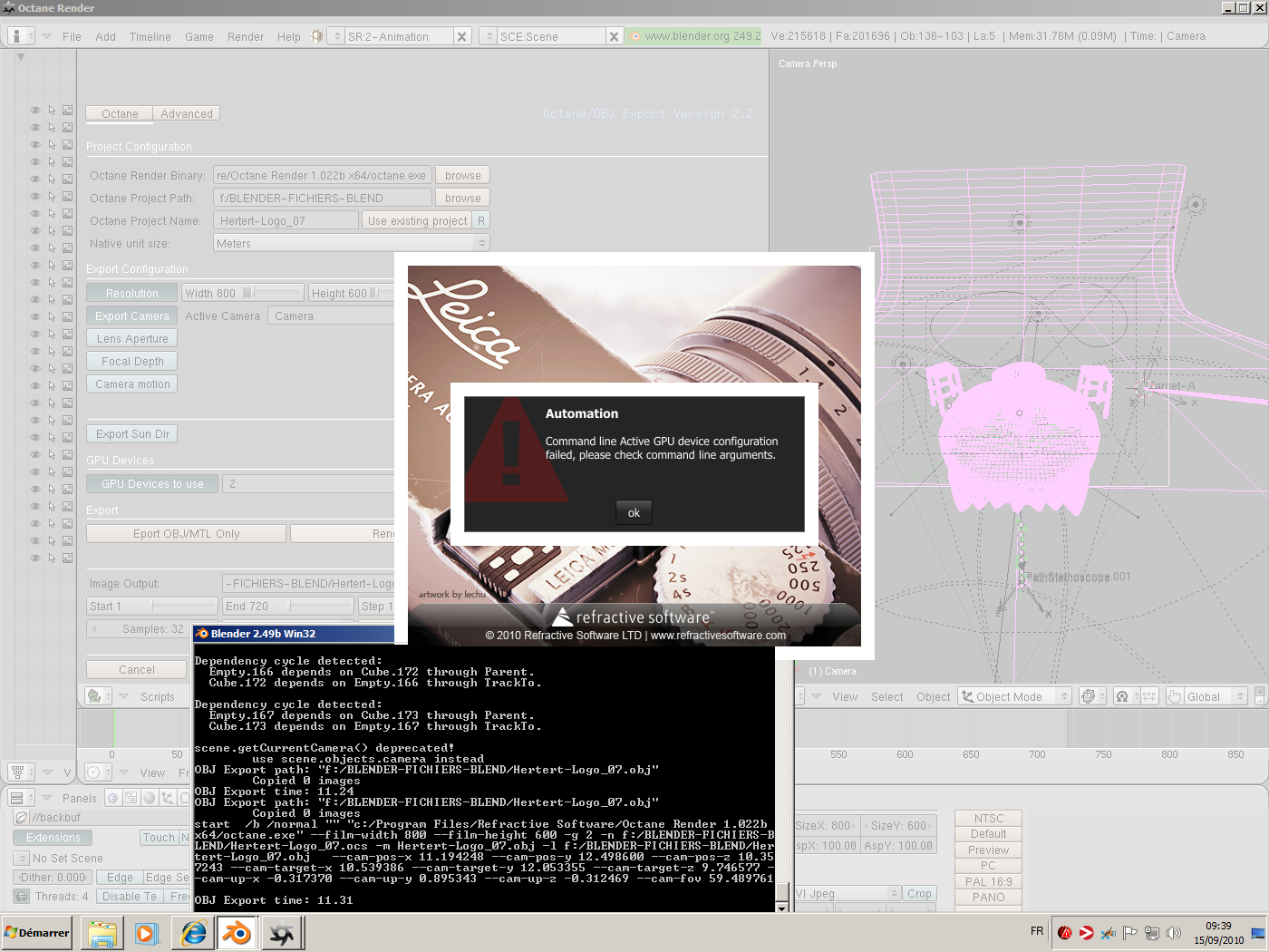

After the exporting, Octane opens and crashes. I get the first screen below :
As I don't use the command line, I don't understand the error message.
I have added the Blender console in the image in case it could help in some way.

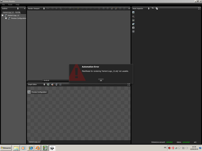

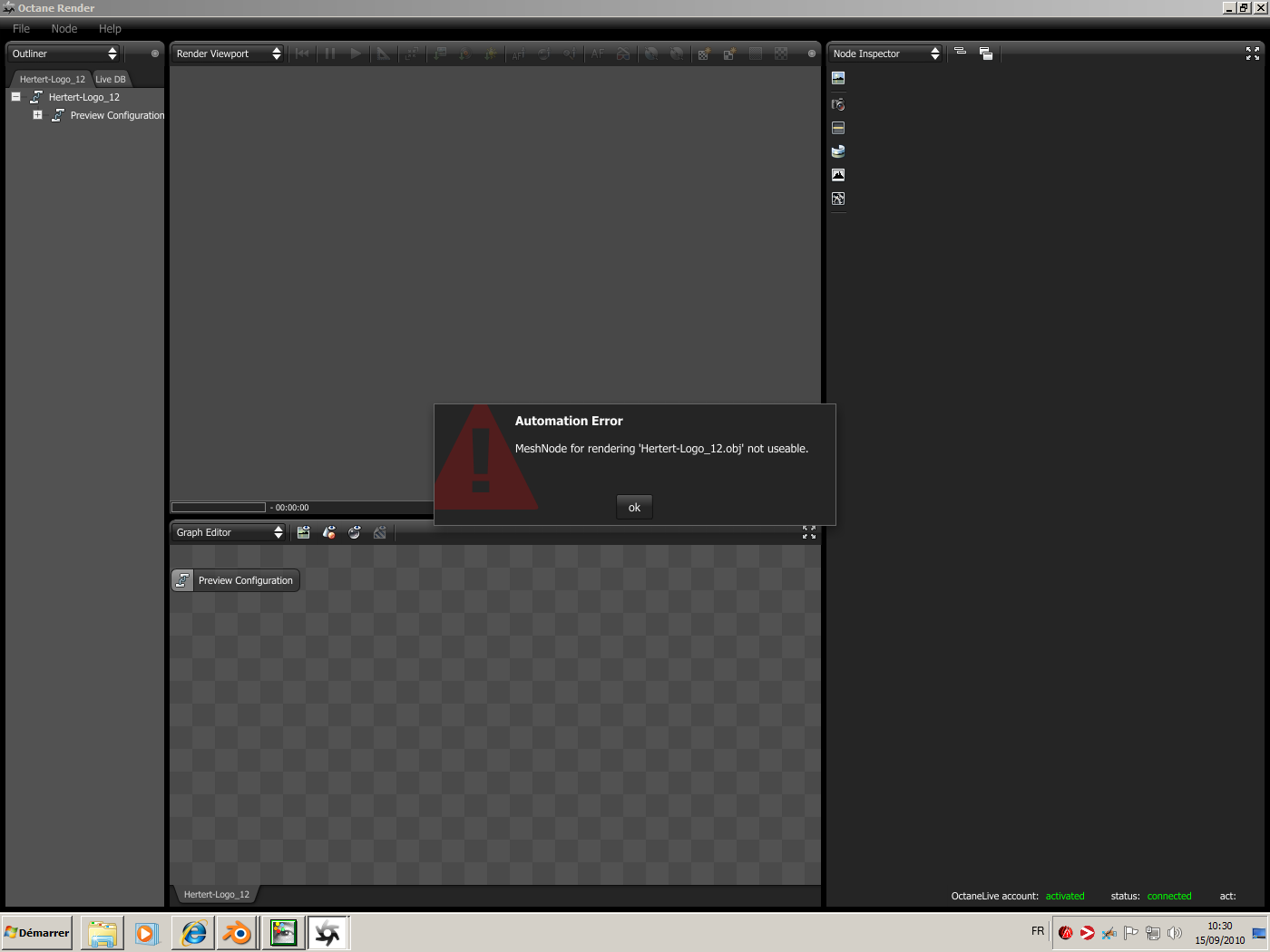

I also tried to open the scene in OctaneLive 2.3. It works fine if opened within Octane, but rendering through the Export script gave an other error message (second screen).
I also got this message one time in 2.2 (I dont remember how i did).
The file pointed by the error message is perfectly valid when loaded by and within Octane !

In the first image: -g 2 means that you want to use GPU3.
If that is correct, forget my post ;)

@Face : thanks, this is very interesting, but the command line parameters are generate by the script. I have only one internal GPU (1) and one external GPU (2) in my cubix box.
I have tried using only GPU 1 or only GPU 2 without success. :roll:
Mybe I shoud try 0 ?

ROUBAL wrote:@Face : thanks, this is very interesting, but the command line parameters are generate by the script. I have only one internal GPU (1) and one external GPU (2) in my cubix box.
The parameter for -g starts with 0 for the first GPU, 1 the second GPU, 2 the third one and so on...
0 should work ever, because i think you have a gpu in your computer ;)

I have tried with 0 : I don't get a crash, but an error message like in screen shot 2 and Octane doesn't render.
Well, I have tried again in 2.3 and noticed that I had forgotten to enable R (replace current obj). Now it renders even animations, but I get a black bar at the bottom of the image. Not yet tried most recent releases, though !
