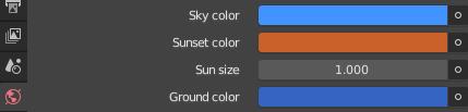

Has anyone noticed that the colors in the “New Daylight Model” settings are not the same as in the standard Octane Edition. I downloaded the DEMO Standalone Edition of Octane and copied the color (Hex) from Sky, Sunset and Ground colors to Blender 2.80 Octane Edition and it looks the same now!
