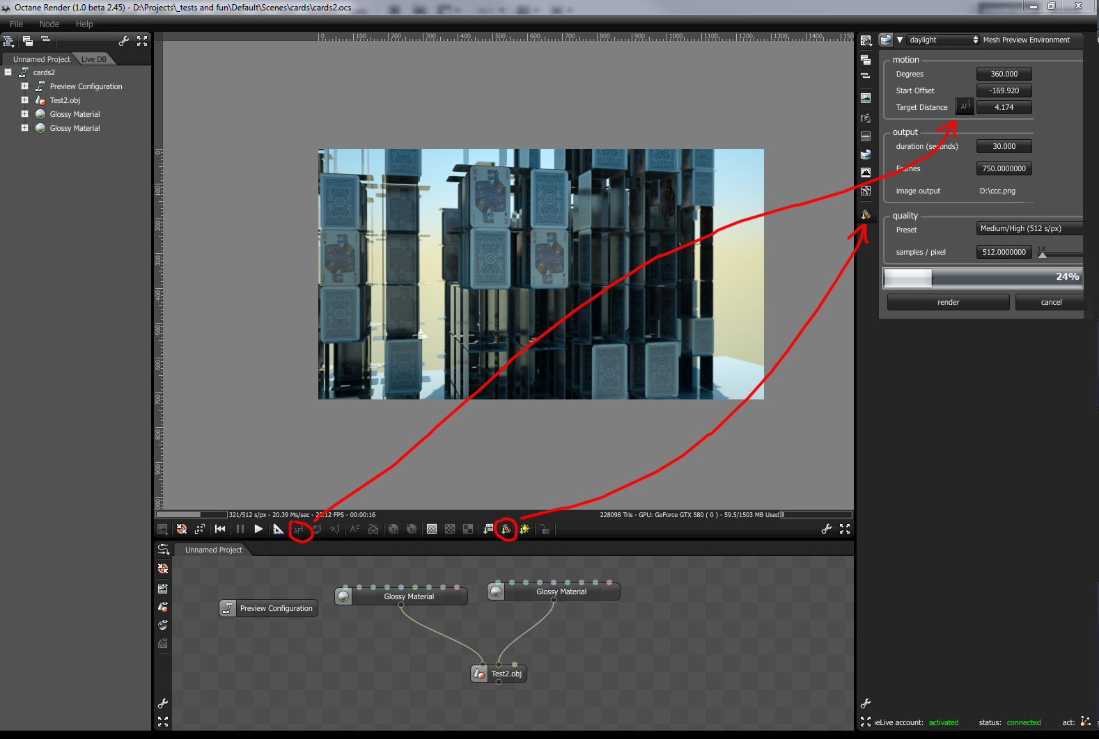

Started to make some more serious tests:
1. is it possible to remember all the settings in "turntable animation" dialog, even between octane sessions? It's very annoying to fill in all the parameters every time you want to make simple animation, noticed some mistake and bah - have to reenter all the numbers/paths/filenames, etc, etc.
2. Is it possible to import camera animation from some text file(suggesting to use simple .chan file from nuke/houdini - it's just a text dump of coordinates), and add something like "use camera animation from file" to turntable dialog?
Well, ofcourse it would be better to have full spectrum of animation controls, but quick hack with turntable would be also good.
3. And final note: it's not necessary to keep "turntable" dialog on after user pressed "render" button. Would be much more handy to have some progress bar with "cancel/pause" buttons right in the main program window instead of useless dialog. Actually whole turntable dialog could be built into right side panel - just add one more button for turntable, progress bar, and we'll be happy. Later ill post the photoshopped screenshot of suggested UI.
