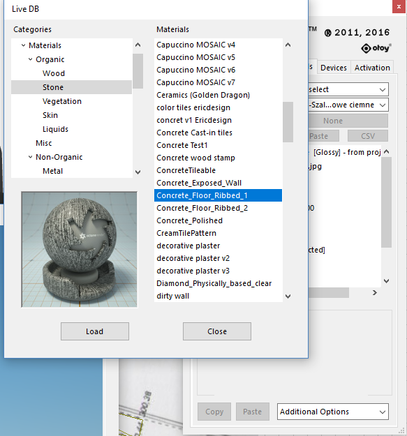

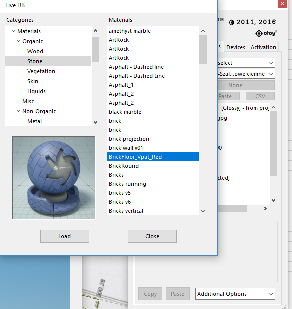

I have 2 more issues with latest build, both tested on 2 computers, AC21 pl, win10:
- I can't deactivate license [ "other instances are still running message" ]
- Materials from livedb are all with blue tint
Przemek

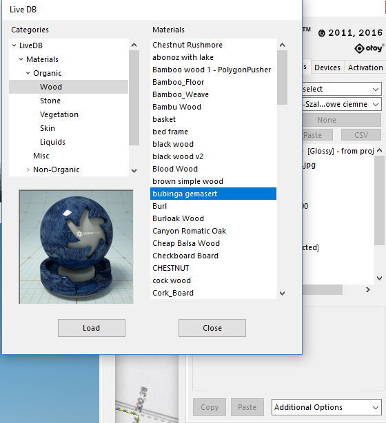

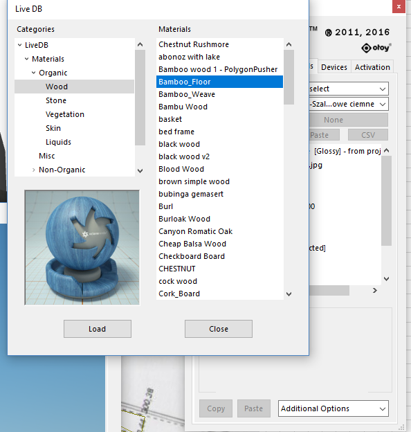

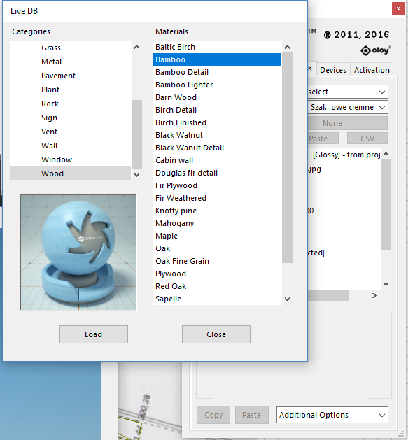

I still have a "blue tint" problem. It is only in material preview window, both preview render and final is OK. Some materials are bad, some are OK. Few examples:
Przem
Sorry this did not get fixed correctly in the latest release. It will be fixed in the next release.

- Fixed issue where LiveDb material previews were mis-colored
