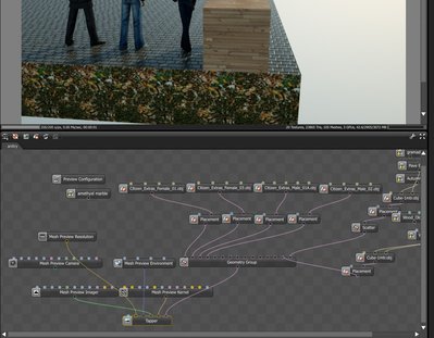

I did it this way:
- 1. - In Sketchup (SU) I used trial version of SU animate to make a lot of scenes (one scene for every frame.. that is 25 scens for one second animation of 25 frames)
In SU I used a basic 3d-model for only making the camera seetings for animation
- 2. - I used the Octane Render Plugin (Thank you so much TIG.. that's great plugin!) with very low pixel sample (only want cam-settings)
- 3. - I changed the cmd file (with help of excel to make it easy) and added "-t <rendertargetname>" (thnx Sighman)
One line for a image looks like this: @"C:\Program Files\...\octane.exe" -e -q -t "rendertargetname" -o "D:\...\img00000.png" --cam-pos-x -0.17 --cam-pos-y 1.96 --cam-pos-z -5.73 --cam-target-x 2.34 --cam-target-y -4.13 --cam-target-z 17.35 --cam-up-x 0.029 --cam-up-y 0.96 --cam-up-z 0.25 --cam-fov 60.78 -g 1 -g 2 -g 3 "D:\...\try.ocs"

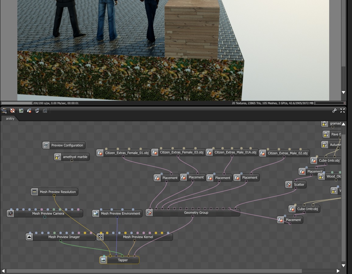

- 4. - my ocs file looks like the image attached. (as you can see I detached the Mesh Preview Camera)
In this cmd line and looking at the printscreen it "rendertargetname" should be the name "Tapper"
- 5. - I ran the cmd file and it made the images I needed for making animation (I stitched them in Adobe Premiere Elements)
I don't know (yet) what the parameters "-e -q" and " -g 1 -g 2 -g 3" stands for?
Can someone explain those?
Is this the way for me to make an animation? Or is there an easier way?
Help and tips is appreciated :P
