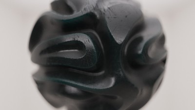

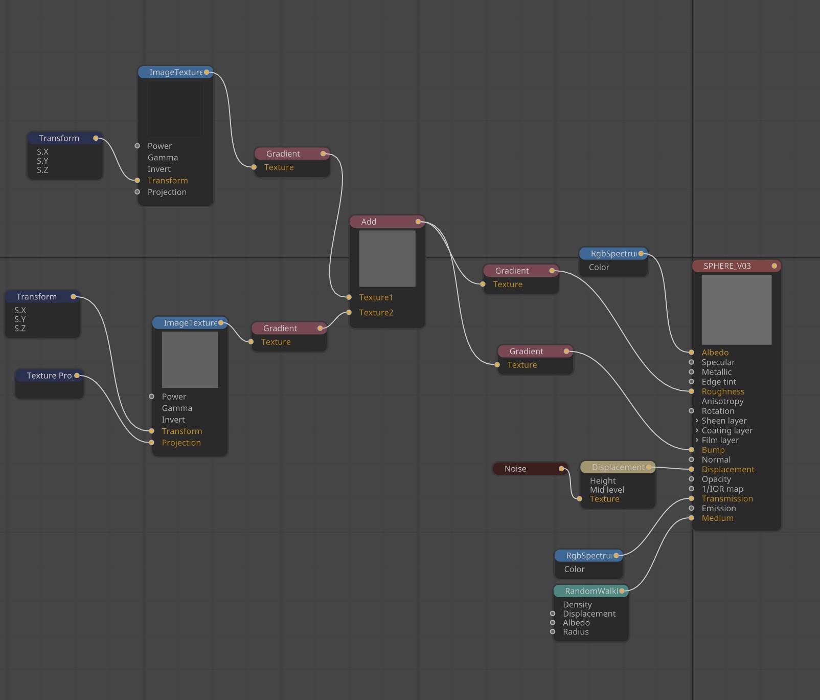

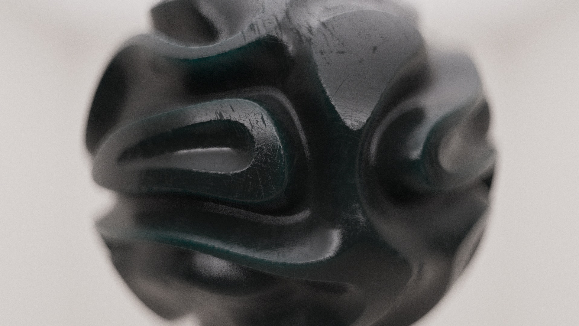

Here is the test
Material has textures for roughness and bump, noise for displacement and randomwalk SSS

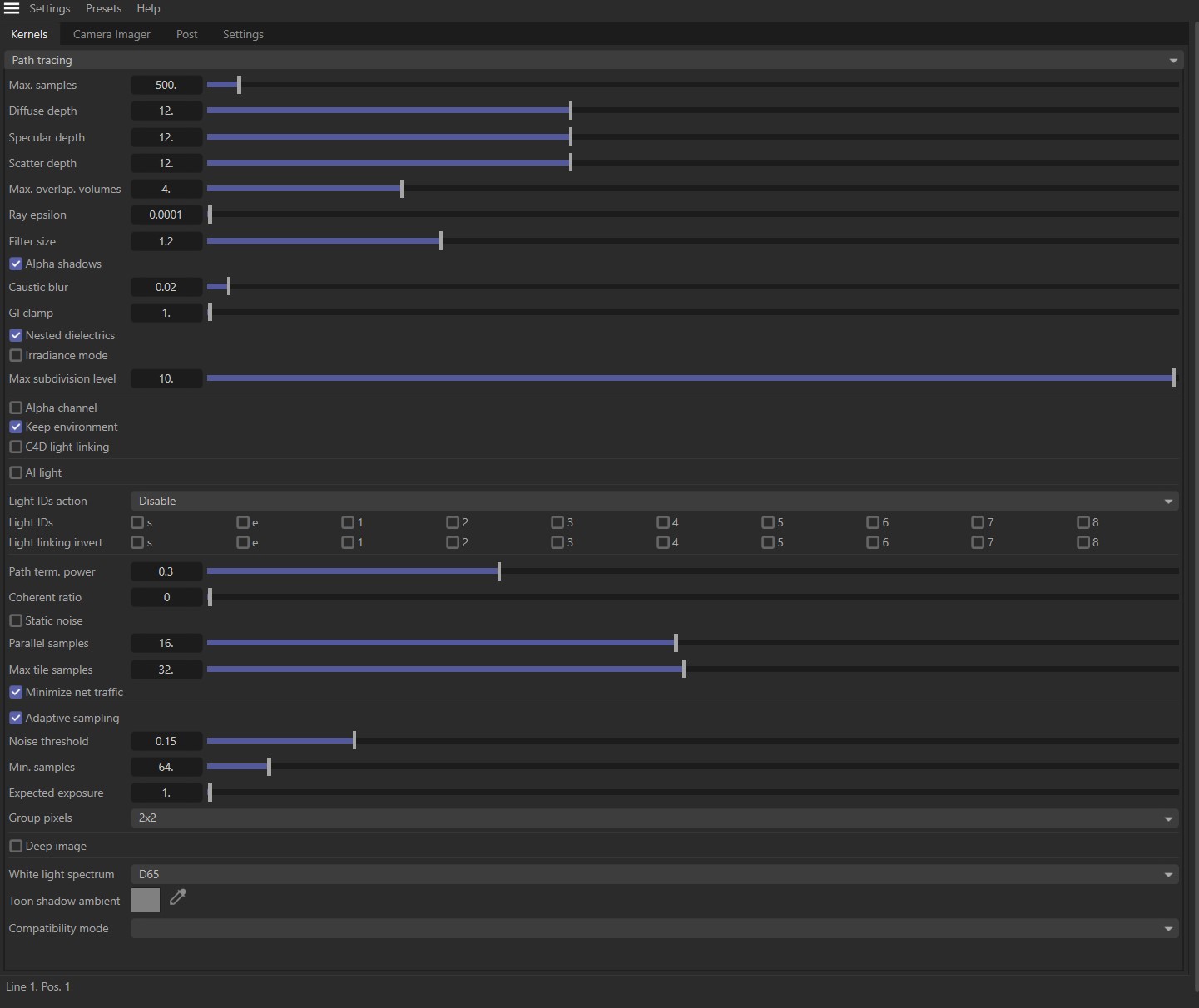

Here are the settings, I've played a bit with adaptive sampling,
which is IMO one of the best way to save render time, depending on how much grain you tolerate
Both machines rendered exactly the same image, which already is a good thing.
So, the Mac was 2:17min, which is not too bad in my opinion.
PC with 3090 is 47s
PC with 4090 is 25s
PC with both 3090 and 4090 is 20s
PC with both cards + 4090 on the network is 17s
Just a simple unscientific test, but frankly I've started this scene with the Mac,
until I really wanted to switch to the PC to precisely work on the material, I could almost instantly see what I was doing.

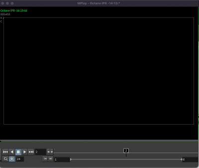

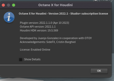

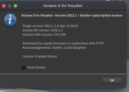

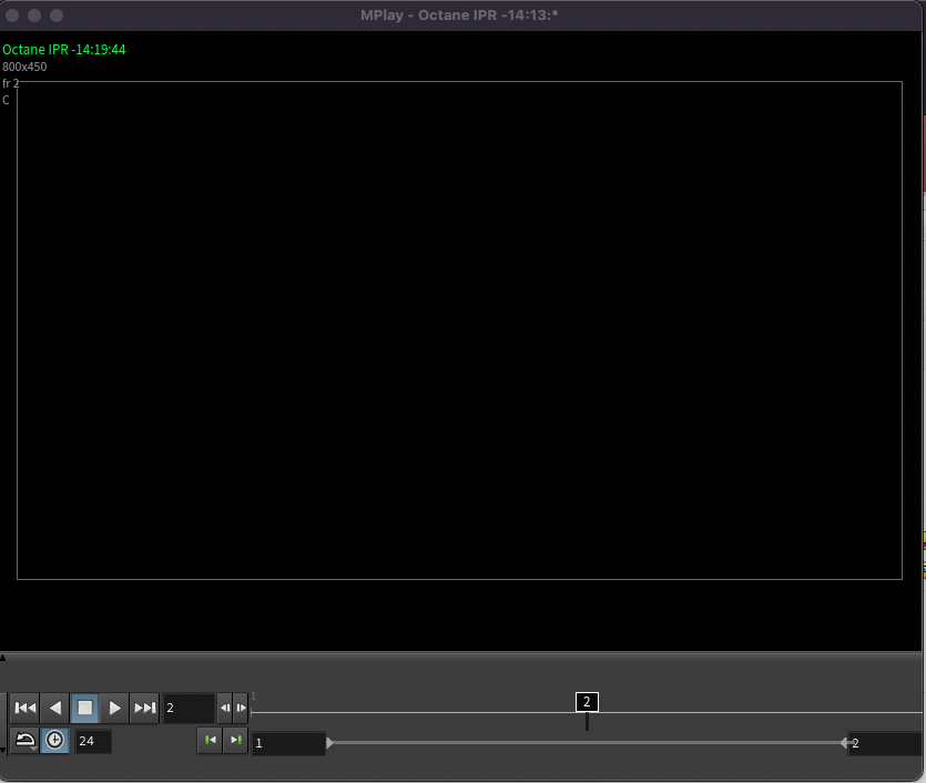

It's been a while since I've used Octane but I'm giving it another shot on my Mac Pro running 12.6.3 on an AMD 6900XT GPU.
In Houdini, I can't get any image to appear in the IPR, and I'm sure it's user error but I was wondering if anyone had a clue as to what I'm doing wrong?
I have followed the instructions in the manual for the basic scene, created a ROP in the OUT context, created a Render Target in the MAT context with a couple of Octane Materials and assigned the materials.
I hit IPR and I feel like I should be seeing something, but it's completely black.
Thanks for any help you guys can provide.
PS
FWIW - the Octane standalone works fine, so I know it's not something with the GPU or my machine.

it seems you have installed the new version for M1/M2 Apple Silicon only.
For AMD GPUs under macOS Monterey, you need to install old PR14 version:
viewtopic.php?f=102&t=79383

But why is there a specific Intel version included in the file then?
This doesn't make any sense. Also PR14 doesn't even work with Houdini 19.5.

Midphase wrote:But why is there a specific Intel version included in the file then?
Hi Midphase,
Thanks for the post.
The Intel version still works on Silicon chips.
Yeah, the last version we supported with PR14 is for Houdini_19.0.531.
