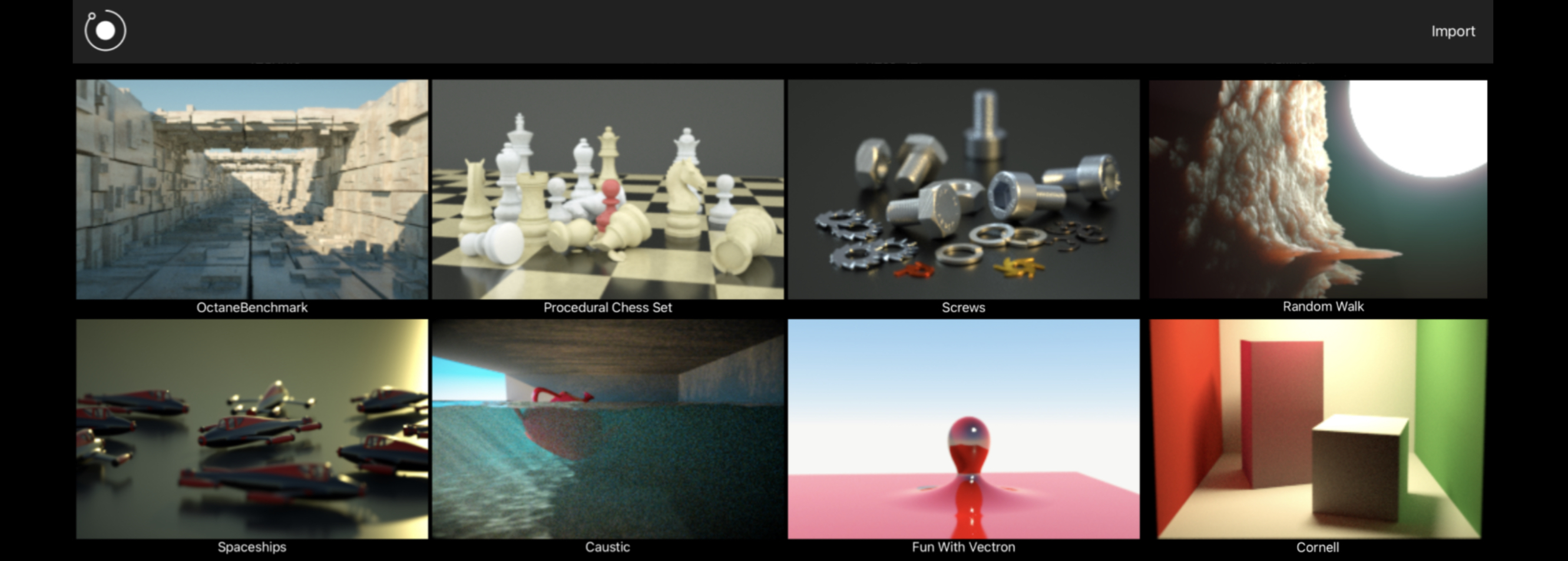

With Octane X now on iPad (wow!) can we now setup something like this: Using Octane X plug-in on a m1/2 Mac and having a m1/2 iPad run Octane X in super user mode & operate as a network slave for the Mac?

Posts: 10609
Hi James,
one of the features of the upcoming new 2023.1 SDK is the Headless rendering feature.
In practice, it will be possible to add a Mac or PC via LAN as if it were an eGPU - connected to M1/M2 Mac or iPad Pro M1/M2 as primary workstation.
Stay tuned...
ciao,
Beppe
