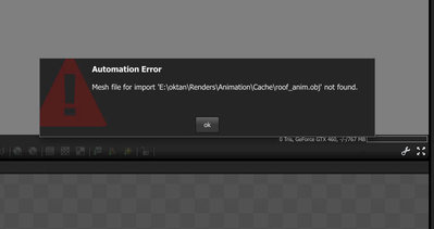

Hi! Does the plugin in 3DS max 2009?
Can you see the video tutorial on working with plug-in?
Keep getting an error when rendering:
Thank you!

satterkein wrote:Hi! Does the plugin in 3DS max 2009?
Thank you!
I don't tried to run it in Max 2009, but as I remember, in this plugin I have used some functions that are not available in Max 2009 script language (only from 2010).
You can view a "Max script listing" after export to see if there are errors... I don't have Max versions earlier 2011 installed...
