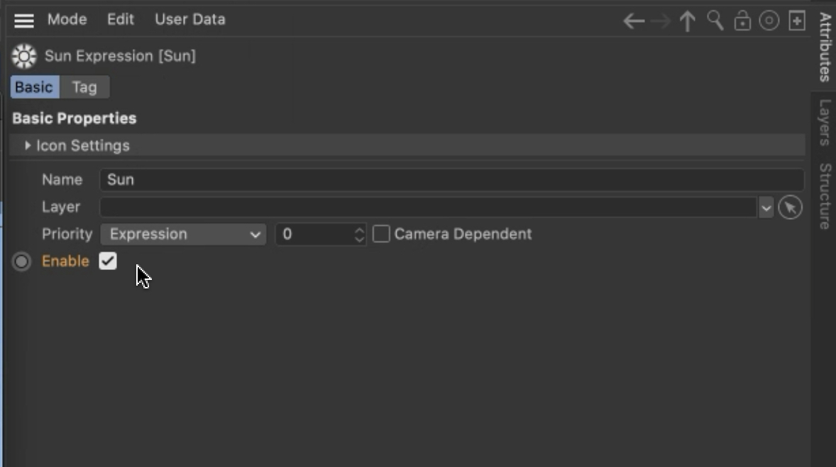

@ keithrondinelli1974: about default Light/Environment, add an Environment node set to black color, or go to Settings/Environment.
About DayLight, the c4d Sun Expression is disabled by default, so you can free rotate the sun, you need to go to Sun Expression/Basic tab and enable it, to be able to change date-time:

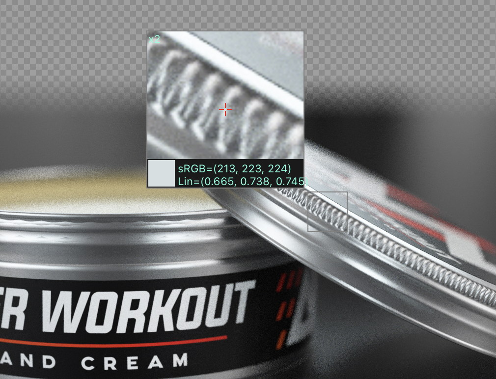

So I have a request, is it possible to set the preview scaling option? So that the Retina screen does not display the image in accordance with its pixels, which are simply too small.
Now only a tiny fragment scales, which doesn't help at all.
THIS! I've been looking for this feature in the CUDA plugin for C4D since I switched from Redshift.
On point! OTOY, please replace this little square with a full zoom of the preview and adjust the image to the retina so that it is not so small.
MacBook Pro 16" | AMD Radeon Pro 5500M 8 GB | 2,3 GHz Intel Core i9 | 64 GB RAM + eGPU Razer Core X | Asus ROG Strix RX 5700 XT OC
Posts: 16068
Location: Türkiye
Scaling the canvas of live viewer is on my TODO list. It's complicated for me than you estimate because of current features of Live Viewer. So not will come immediately or soon

As a temporary solution, I recommend installing the free Display Menu application from the Mac AppStore. You can (literally) change the screen resolution. Thanks to this, the image from Octane Live Viewer will be larger. It works great !!!
