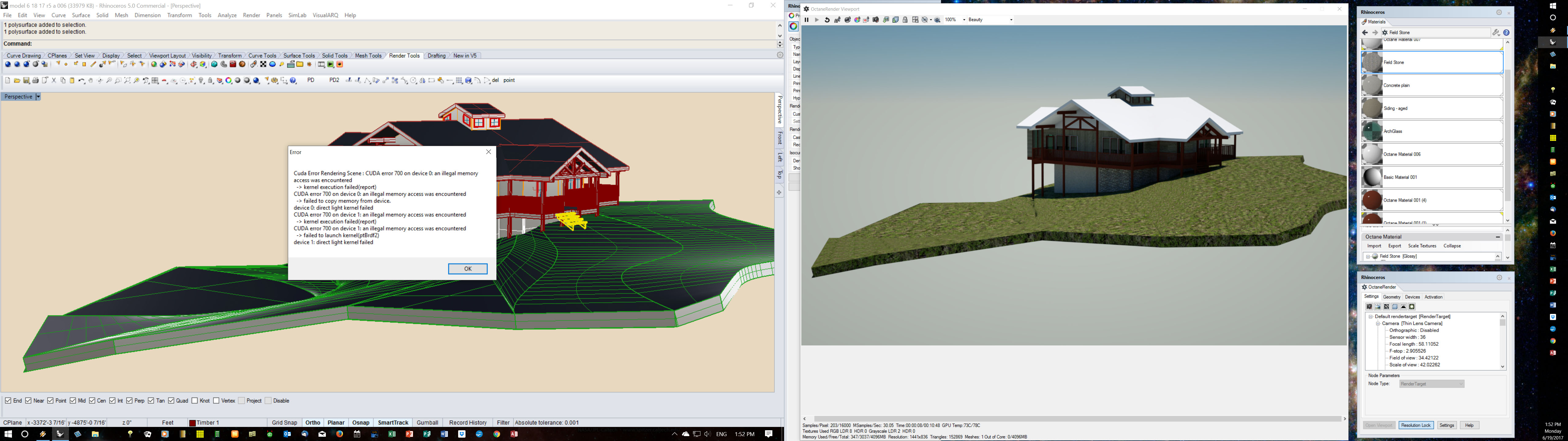

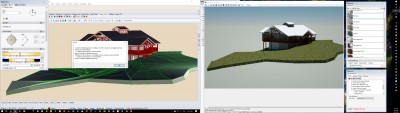

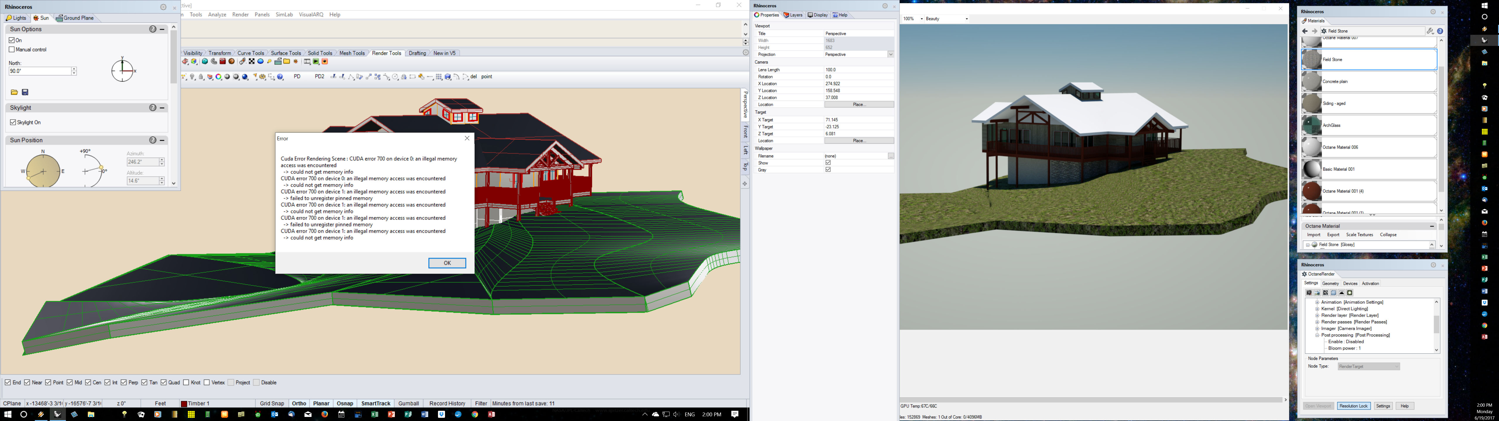

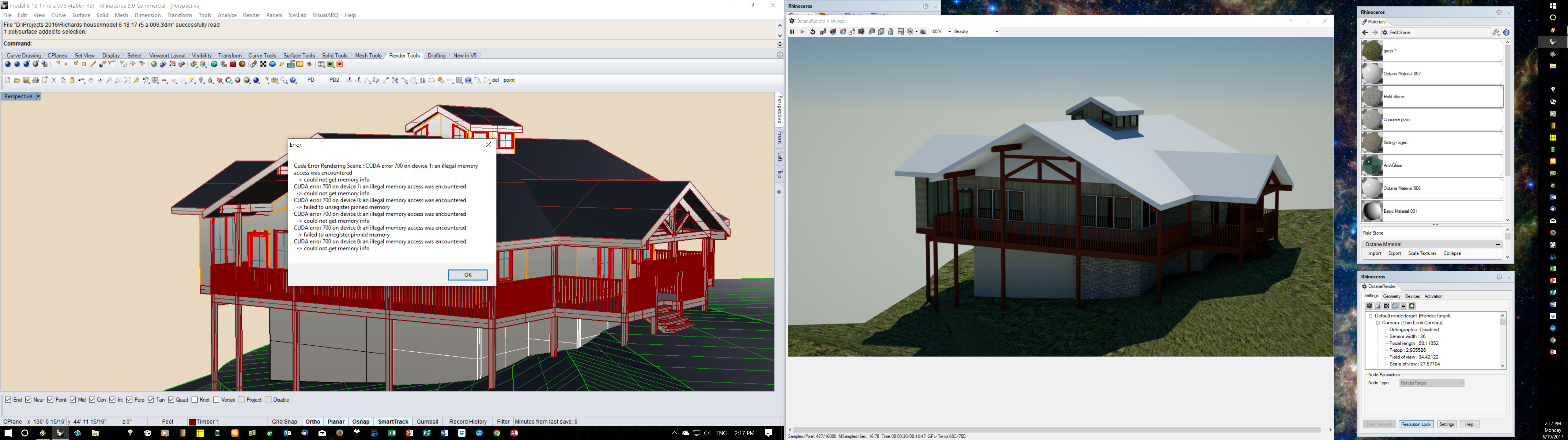

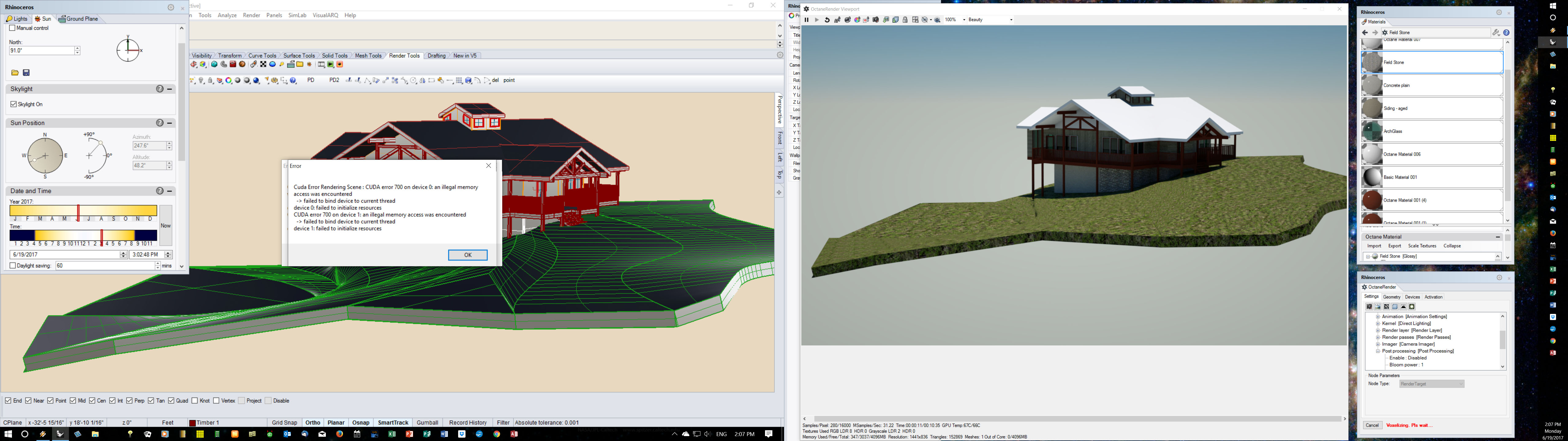

Numerous cuda crashes (see attached) .. Frequently have to restart Rhino
Win 8.1,16GB,i7,GeForce GTX760(4GB),(GeForce 334.89 driver, GeForce GT640(4GB) Dual 27" monitors
face_off
Posts: 15822
Location: Adelaide, Australia
Eric - those errors look like a hardware issue. I suggest trying to render with each card in isolation? That will tell you if it is one of the cards causing the issue.

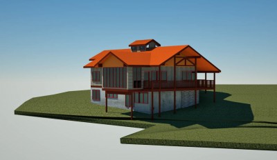

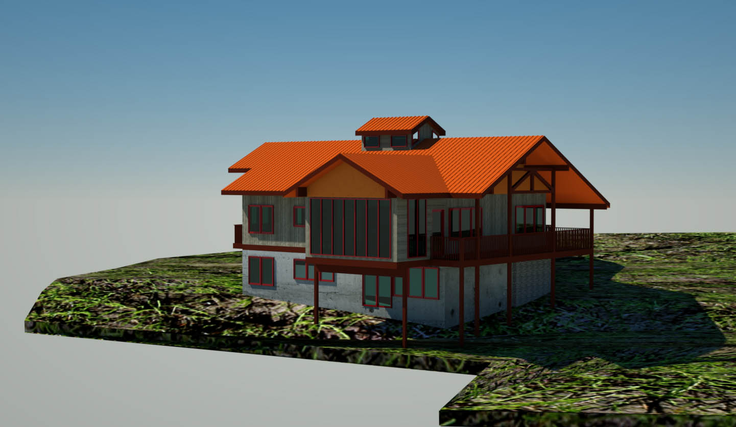

Hi Paul ...

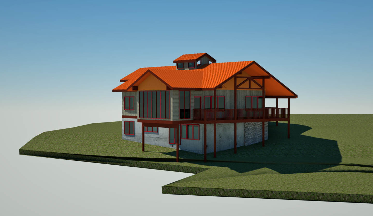

Look at the grass as an example ... every time I open the Octane viewport the materials revert to their seemingly default texture scale settings ... I have to change the grass texture to the desired setting every time I open Rhino/Octane
Note also that the siding is vertical in come cases and horizontal in others. All the same layer. How do I change the surface normals to match?
eric
face_off
Posts: 15822
Eric - can you pls send me that scene.
Paul
