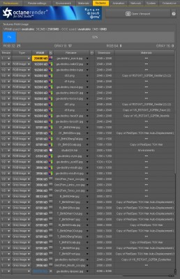

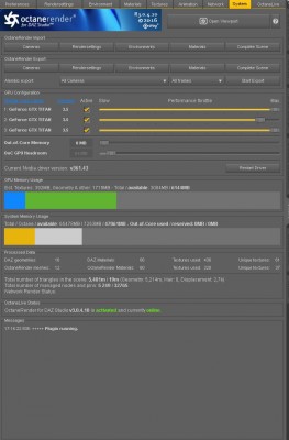

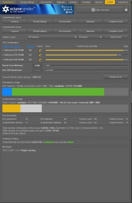

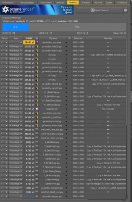

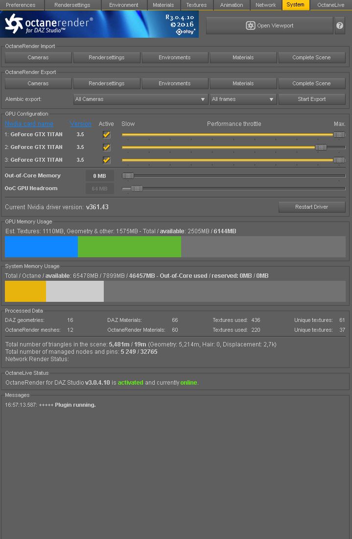

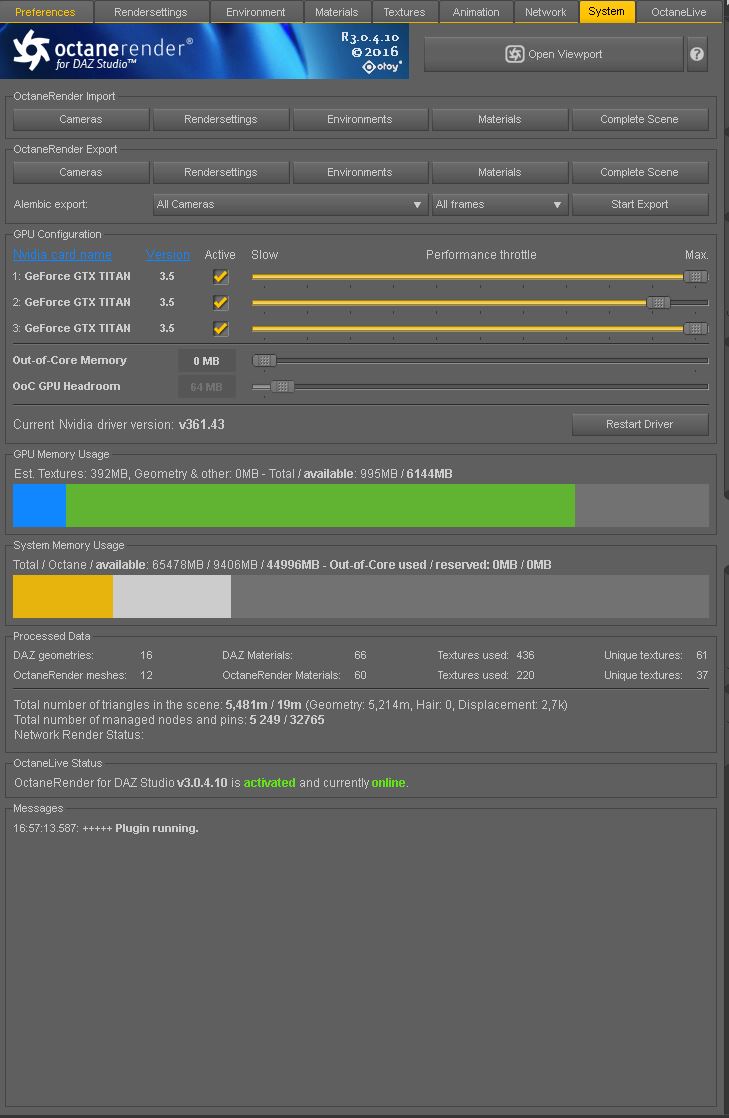

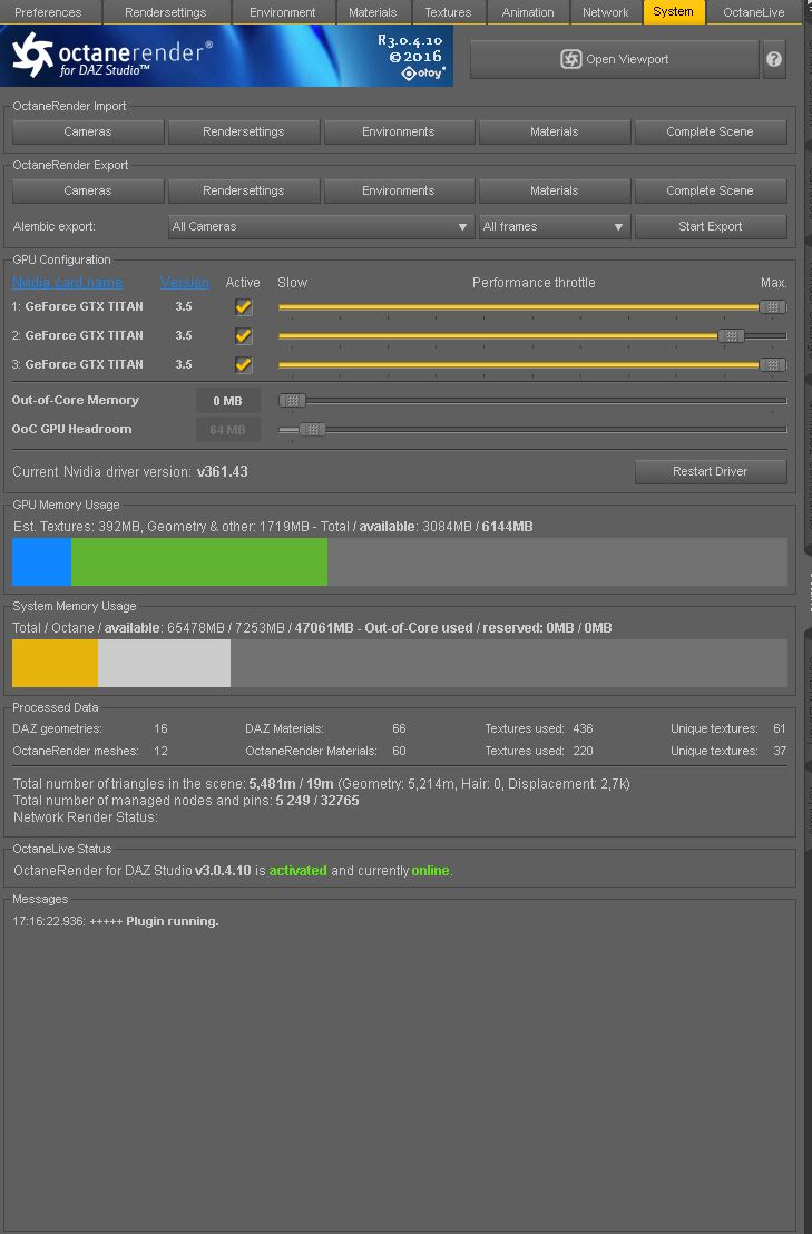

Hi Paul,
Sorry, I spoke too soon. I have in fact just test with a scene with nearly 3GB VRAM (just the limit of 780Ti).
Just retest with a single V7 and resized work --> decrease of texture OK, little change on geometry.
With bigger scene, something goes wrong and despite texture decrease, the geometry seems to get bigger. So after resized texture of my scene, I have CUDA failed as VRAM exceeded 780Ti.
I found a work around for this. After resized texture, close DAZ without save and restart DAZ and reload the scene. The texture remain resized (so the resized texture are NOT saved with the duf, but stay resized for all other scenes !).
Just load and render (no texture resized)
resize texture :
--> system pane geometry VRAM ???
Close DAZ and restart and reload the scene and check :
Gain : 700MB on texture / Lost : 150MB Geometry for this scene. Good point !
