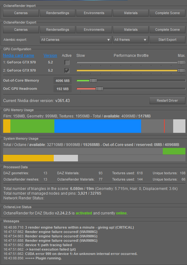

Ok I am not sure what is going on lately but all of a sudden certain scenes will cause my drivers to crash. Here is a screenshot of a scene I am trying to render. It is within my cards boundaries so I'm not sure why it is continuing to crash.
Can you try reinstalling Octane Standalone from the installer EXE pls - there will setup the Nvidia timeouts correctly.
Paul

I applied a Windows fix before I went to bed last night I will see if that worked when I get off work. Is there a specific version of octane that needs to be installed?
Any version - as long as it's the installer and not the .ZIP.
