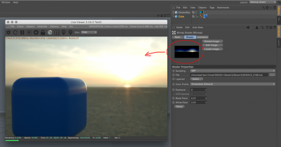

Weezer wrote:I've been playing with the latest release, which is very impressive, but noticed that where before I could make changes to my HDR images in the Sky object, now I can't. Things like White and Black point and Exposure don't do anything – I'm sure they worked on the same sort of HDRIs previously. It's really useful feature – is there any reason why this functionality isn't there any more or has stopped working?
I have tried with a selection of HDRIs...
I didn't understood what are you doing. A scene or image will helpful. This is test version and i'm re-organising some parts. So this is normal but feedbacks help to detect problems.
Simply: I have scene with an Octane Sky object. I am adding an HDRI to it. When you click on the Texture button (the long one that says/Volumes/Hard Drive/HDR... ), I am normally able to change the Exposure, Black Point and White Point, which you can use to tweak the HDR (some are shot at different levels/exposures). The preview window changes but it doesn't affect the result in the Live Viewer. I appreciate this is a work-in-progress, but thought I'd mention it.
Pic enclosed…
Posts: 16068
Location: Türkiye
Weezer wrote: Simply: I have scene with an Octane Sky object. I am adding an HDRI to it. When you click on the Texture button (the long one that says/Volumes/Hard Drive/HDR... ), I am normally able to change the Exposure, Black Point and White Point, which you can use to tweak the HDR (some are shot at different levels/exposures). The preview window changes but it doesn't affect the result in the Live Viewer. I appreciate this is a work-in-progress, but thought I'd mention it.
So you're on wrong way. These parameter are ridiculous for Octane. We didn't ever supported that. Imagetexture is the way to go and its parameters.

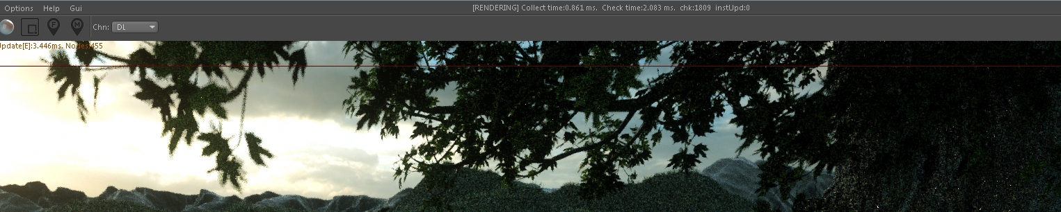

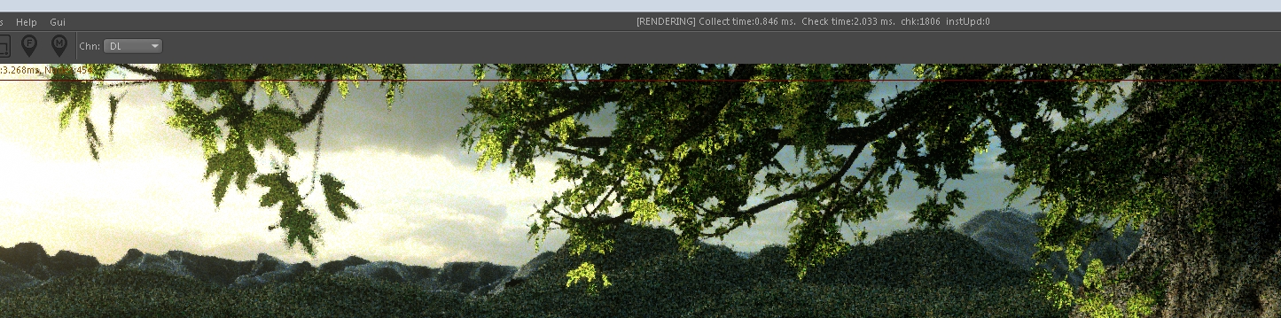

hi ahmet,
one question: is it normal that the lightdistribution is completely different when using a colorcorrectionnode in the HDRI object? even if all values are standard in the colorcorrectionnode the resulting render looks different. could it be that the importance sampling is deaktivated while using the colorcorrectionnode?
with CC-node inserted
without CC-node
