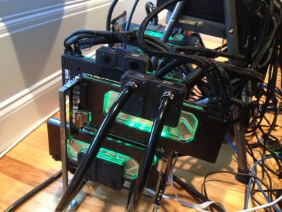

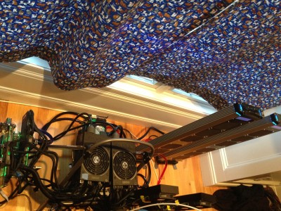

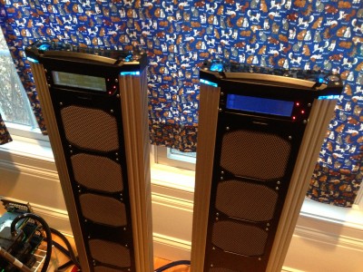

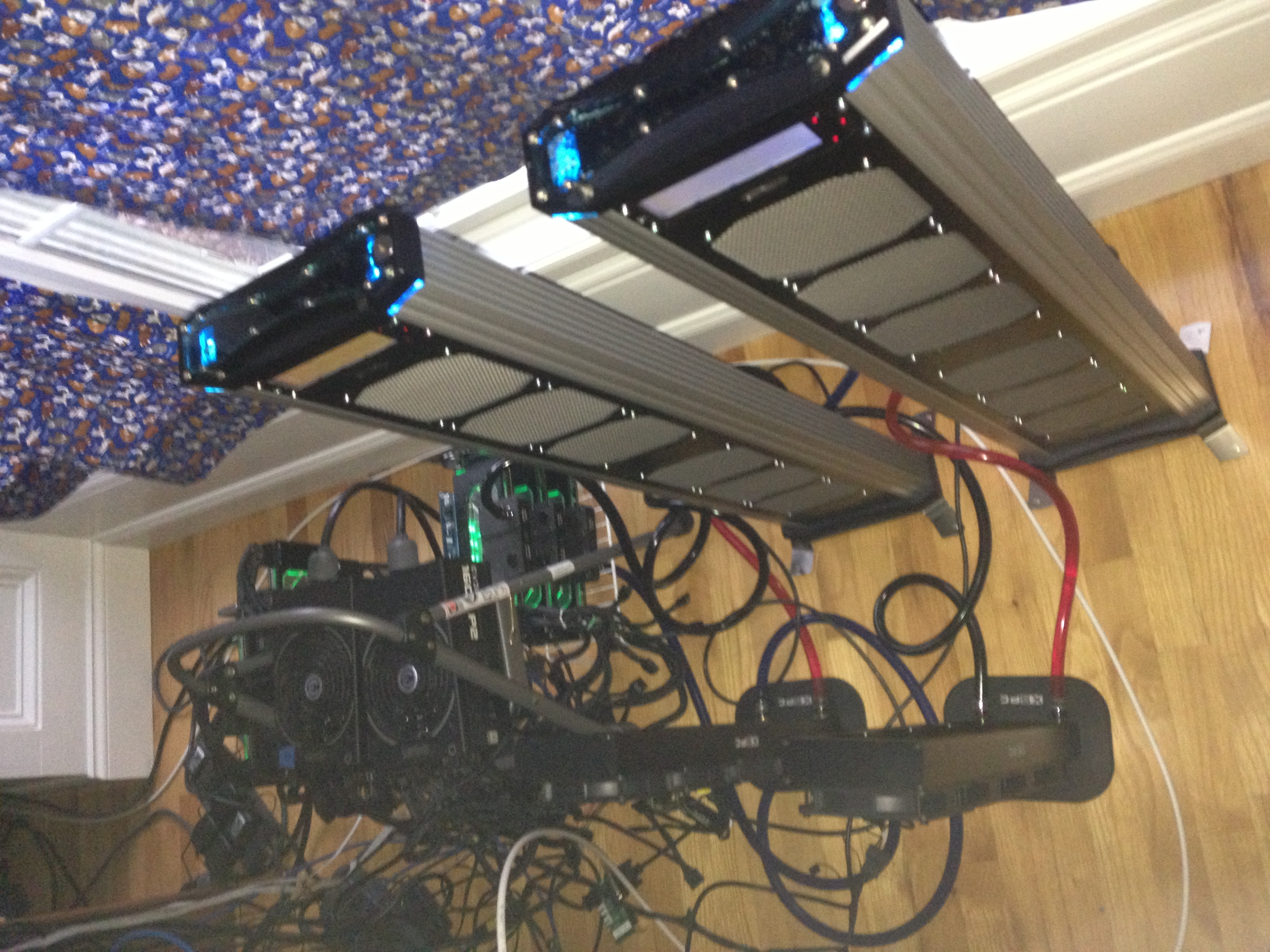

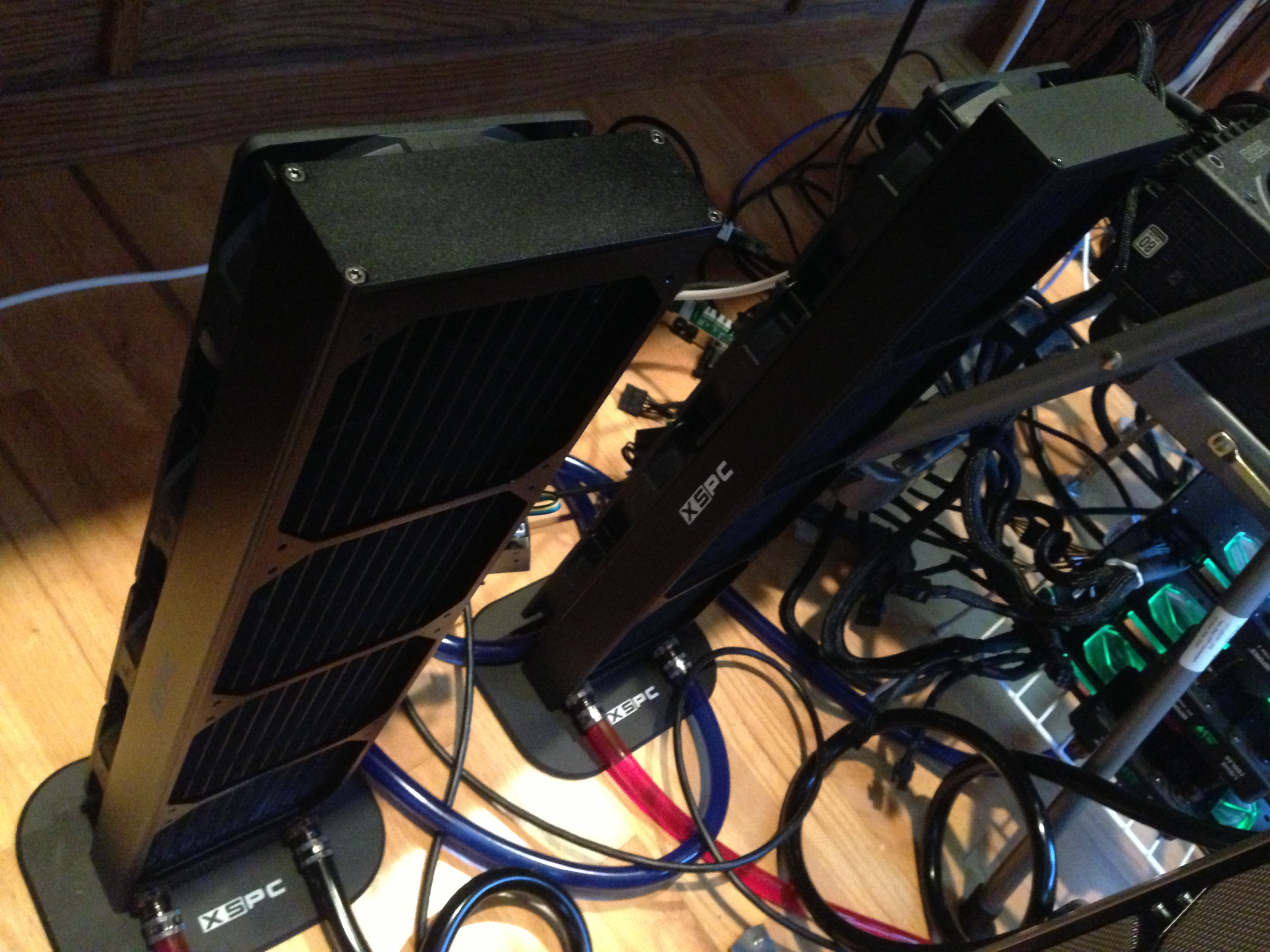

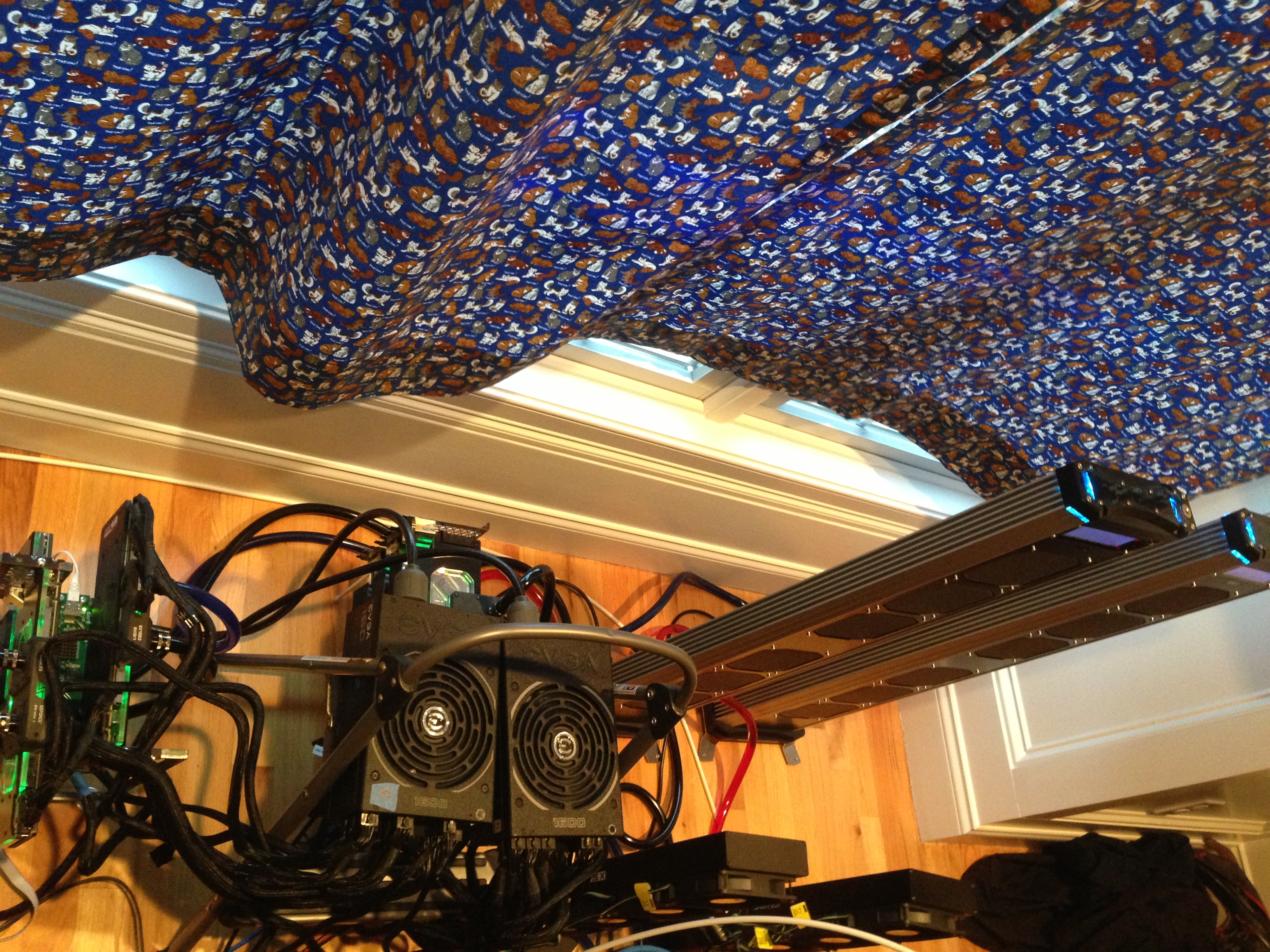

Hello! I completed the waterblock on the 3 Amfeltec-connected cards and now have all 6 Titan Zs watercooled.
It was tricky...The Amfeltec did not want to cooperate with the pump at first, as it positions the cards at start with challenging vertical air locks, and I wanted to arc the tube connections so they never ran with the potential to drip over the center PCI board, which meant I had to run 12"+ tubing SLI connections between each card in orbital paths. (As opposed to my 1" USB riser Swiftech SLI connections directly between each card...) I was getting little to no flow and I was considering I would have to return to air. What I did to overcome was to fill all 3 of the waterblocks with water before-hand manually with a funnel through the main tubing line, and then connected the main tubes to the Aquaduct, and then ran the pump to prime the loop. Since there was water already throughout the toughest parts of the loop, the head pressure was able to push the liquid without fighting any giant air pockets, and I was in business. Not only that, but I was able to add a supplemental XSPC AX480 Quad Fan Radiator on the loop to boost cooling. I had already added one for the 3 USB Riser cards which dropped my coolant by up to 10 degrees and the cards themselves by up to 20 degrees in extreme rendering cases, so I wanted one for the 3 Amfeltec cards as well. Low and behold, the Amfeltec cards run cooler than the USB riser cards by 10 degrees at times. I got to hand it to the Amfeltec, a PIA to set up, but it takes care of its cards and is a great rendering weapon.
Side of the 3 USB 3.0 Riser Titan Z loop
Side of the 3 Amfeltec Titan Z loop
2 Aquaduct 720 XT Mark V, 1 per loop
2 supplemental XSPC AX480 Quad Fan Radiators, 1 per loop
3 Watercooled Titan Zs on the Amfeltec 4-Way GPU Cluster - (Swiftech Komodo Waterblock).<br />Tubing runs outside and under the cluster.
