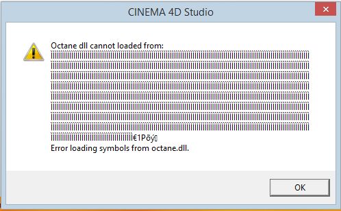

Hello,
you have any suggestions for this error?
Testing Beta version 0.8.7b (SDK1.20)
Windows 8.1 preview
cinema 4D Studio R14.042
Many Thanks !

what kind of plugins is available on plugins folder?
look this:
http://render.otoy.com/manuals/Cinema4D/?page_id=651
look this:
