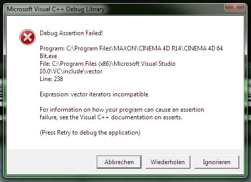

did some more animation renderings with 0.6.8a and the picture manager renderer and still get random crashes after 50-100 frames with some projects. I disconnected one of my GTX590 and don`t got any bluescreens since that, need to do more testing to find out where the exact hardware problem is, hopefully its not the VRAM.
But for random crashes see this debug error crash message during animation rendering... don`t know what kind of failure this is, nor if it is caused by octane, maybe you have a clue?

Hi Chrisvis and all,
i made important fix to get away this frustating error on renderings.
Please update from:
http://render.otoy.com/forum/viewtopic.php?f=30&t=33493
i have checked arelight problem but cannot found any problem.
