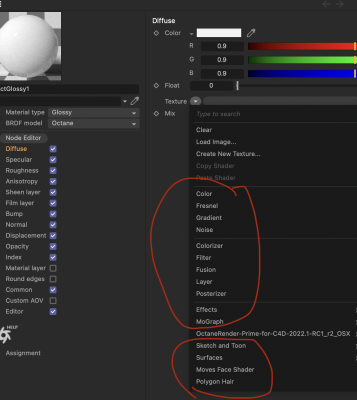

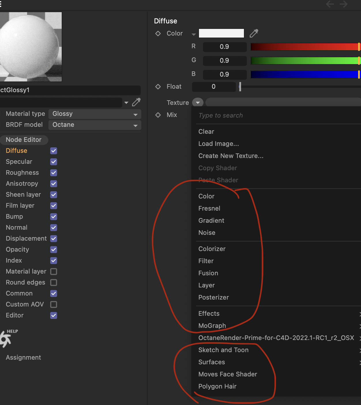

It works but i can't use this note . It's bug

Yes please, avoid to use C4D nodes, Octane has its own nodes.
For example, you can replace the C4D Gradient shader with the new Octane Gradient Generator node:
And the C4D Noise shader with new Octane Noise4D node:
