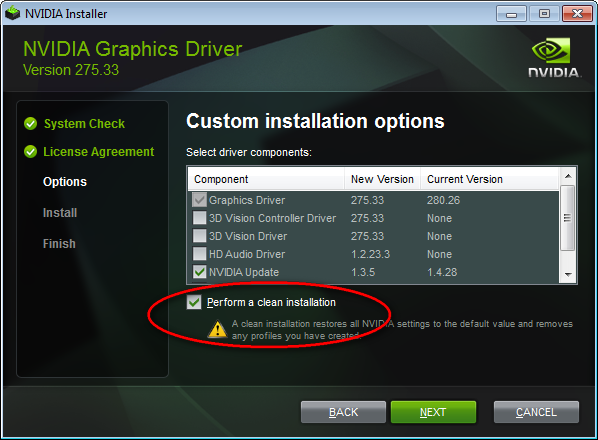

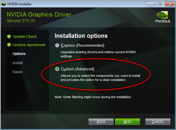

Yes, just download the driver and launch the installer. In the dialog where you can choose between "Express" and "Custom" install, pick "Custom":
In the next dialog, enable the option "Clean install":
This guarantees that everything gets installed like in a fresh install. The only problem is that you then have to disable the multi-GPU mode (SLI) again (see my previous post).
Will that make 2.49b RC work again with alpha channels correctly?
Yes, that should do the trick.
