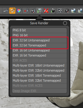

Sorry Paul, I really appreciate providing the v4 plugin but I'm unable to save my render as 32bit EXR now. When I click either of these nothing happens:

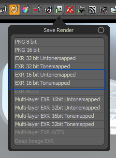

Also if I save as either 16 bit tonemap, or 16 bit non-tonemap EXR they actually save as 32 bit.

Hi Dino
Sorry for the save issue. Unfortunately the plugin code has moved a lot with 2018.1, 2019.1 and 2020.1, and it looks like this code change has broken the Octane 4 version of the plugin. Sorry, but I think the time to upgrade to the latest version has arrived.
