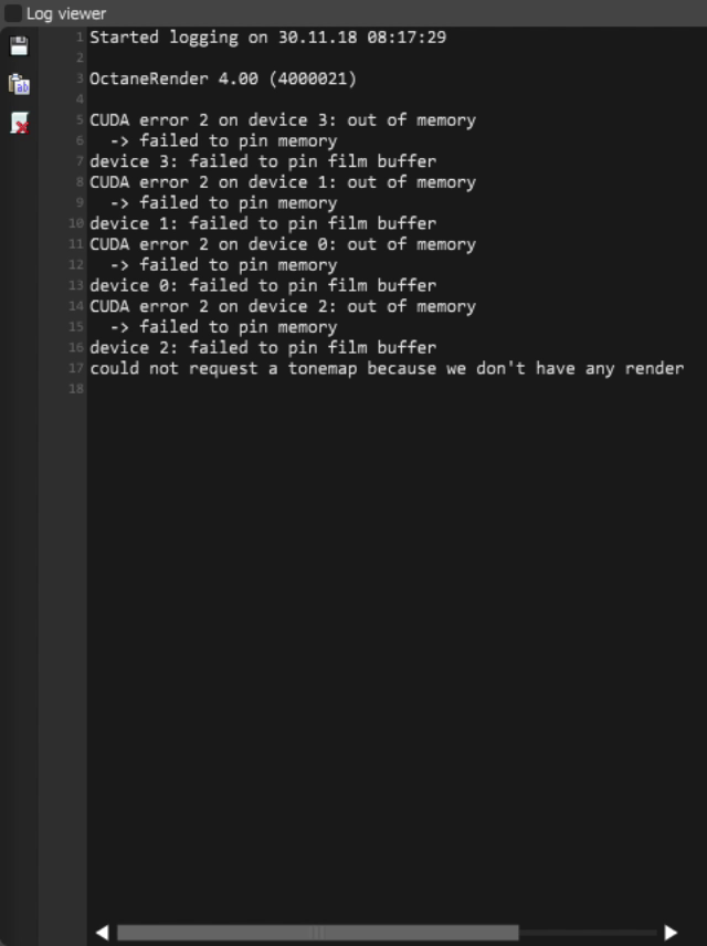

Hey everyone,
following up on my previous post concerning Octane crashing while saving out a frame when I'm rendering in a higher resolution.
I'm pretty sure it's the denoiser that causes the problem, since it just disappears, when I disable it. Unfortunately, I'd need the
denoiser to work, especially since it's a kinda large resolution for a print ad, so there can't be any noise.
See a screen grab of my log attached. I'm a little confused, since there's like 4gb of VRAM left - yet it says it's running out of RAM...
Also, is there a way to work with the render layer system and use the denoiser on the "Black Shadows" pass? My Beauty pass is
getting denoised but not the Black Shadows pass.

I had the same issues. I noticed that one of my "Image Texture" was set as to "RGBA - 8bit(BC7)(high quality)" Instead of auto in the "Texture Import Type" setting.stefano-dear wrote:Upstefano-dear wrote:My slave computer on network render doesn't work any more:
OctaneRender 4.00 (4000021)
Launching net render slave (4000021) with master 10.39.12.184:1025
unpacked file image has unexpected type
didn't receive all required images from master
invalid message received from network connection
slave crashed or was stopped via CTRL-C
Started logging on 27.11.18 13:59:06
Any solution?
MAC 10.12.6 + GTX 1080Ti - Driver NVIDIA 387.128
SLAVE Win 10 + 3x GTX 1080Ti + 2x GTX 980Ti - Driver NVIDIA 417.01
C4D R20.026
After resetting it to "Auto" the slaves worked again and did not show "unpacked file image has unexpected type" anymore. Maybe that helps!
