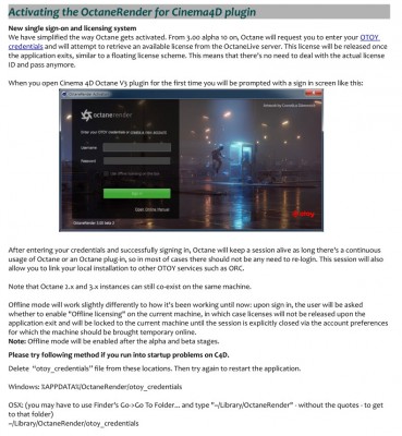

Is there still someone with login issues? Please describe your OS too.
As a workaround, i created V3.0-R1.1 which fixes an bug on plugin.
And an old beta version(Beta2.1) is on release page. You can try if you still have problems. Please give me info about your last status.

Hi Aoktar,
yes still having issues here.
Standalone 3.0 launches fine - no problems now. In C4D I am asked for credentials. When I hit ok C4D Plugin says that all my licenses are being used. This is false.
I somehow need to free this mystery C4D license so I can use it.
I am using Octane standalone 3.0
Octane C4D Plugin 3.00 - R1.1
Windows 10

sorry but this does not fix it for me
I deleted the suggested file which in my case was in C:\Users\OC\AppData\Roaming\OctaneRender
I was previously testing the plugin on my machine at work which was de-activated and shutdown. So its definitely not active.
So unless that activation gets de-activated how will this work?
also yes I am using my credentials to log in at the splash screen.

HOW LONG WILL THE BETA VERSION CONTINUE TO WORK? I will wait until the weekend to try to upgrade. I am confused about the licensing procedure and the problems people are having.aoktar wrote:Is there still someone with login issues? Please describe your OS too.
Is there one place to find the definitive instructions for upgrading on Mac OSX? I am finding "instructions" and workarounds buried in posts all over the place.
THANK YOU, AOKTAR!
Alright, updating to R1.1 fixed it for me. Thanks, good work! :D
Windows 10 Pro -- RTX 2070 x 3 -- Ryzen 1920X, 32GB -- Blender, Standalone, Cinema4D
Cool!Chromfell wrote:Alright, updating to R1.1 fixed it for me. Thanks, good work!
I suppose until June 1. Informations on release post might be enough in normal case. But it's messed up and don't know exactly what's happening. Propably some unexpected cases due Operating systems.rwalker wrote:HOW LONG WILL THE BETA VERSION CONTINUE TO WORK? I will wait until the weekend to try to upgrade. I am confused about the licensing procedure and the problems people are having.aoktar wrote:Is there still someone with login issues? Please describe your OS too.
THANK YOU, AOKTAR!
If still someone having trouble please send me PM. It will be better to follow up the case.
