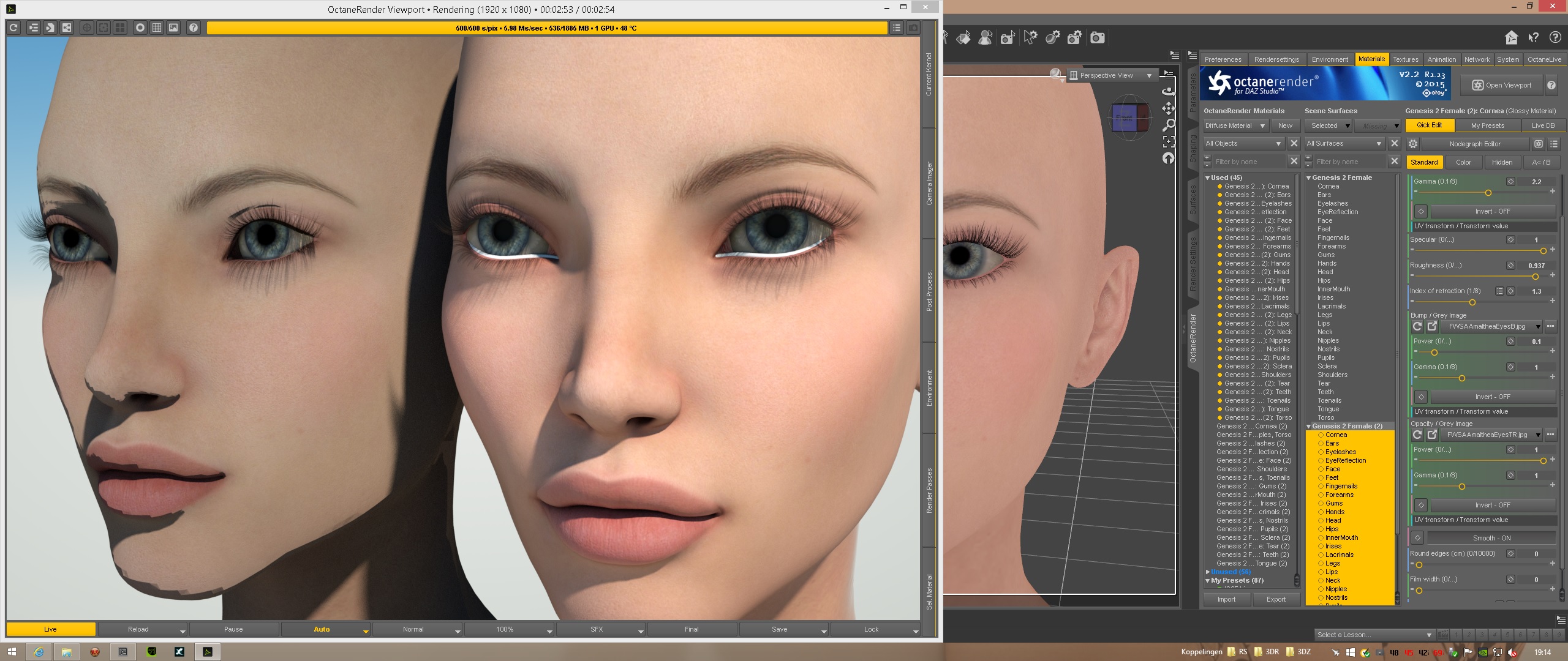

There is an easier way if you want the "old" way of skin textures (ok i find it easier ;) )
- Select Genesis 2 in the scene surfaces list (all textures)
- Right Click, select Create as new materials -> Blank Materials (shortcut: ctrl+shift+B)
- Again Right click, Select textures for octane materials -> Take and connect all maps
Now only the textures are applied and not the new standard template. I prefer this methode as a starting point (when i'm not using redspec shaders, they are way better than anything i can make :) )
(Left new template, right above methode)
