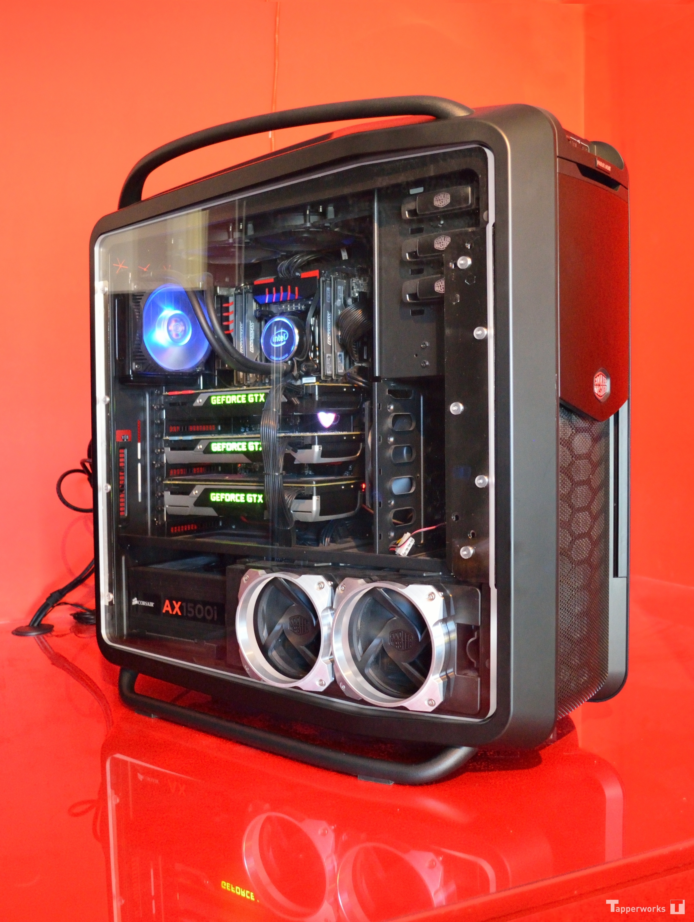

OK, after almost two years hereby a post ..sort of closing down relatively tothe first post :lol:
You guys did not talk ithe idea out of my head... Due to other build (slave machine with double TitanZ), this build ended up with the TitanZ and a Black and X as upstaries neighbours :) Nicely with open space between the cards.
To pleasure the cards I recently gave them a view outside by replacing the side panel with a custom made panel by Mnpctech.
So, this is the final look...
11 months ago I received the panel, but only recetly I took 15 minutes to swapp the standard side panel for the Mnpctechwindow panel for the Cosmos II Case.
The panels are machined in Cast Acrylic with edges polished by hand.
It was peanuts swapping the panel and installing the 2 Mnpctech fan rings.
The next thing to do is design a 120mm logo to print 3D and install it together with a dust filter on the inside behind the fan rings... after finding another 15 minutes or more. And remove the standard fan cable that you see and add LED strip inside.
Resume: it was a very good idea!

Simply beautiful, elegant! Great job. And the panel looks great.

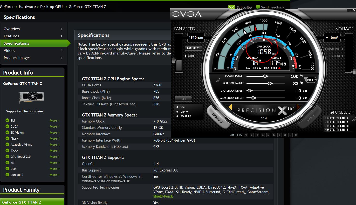

PS. What are your core clocks on Z?

smicha wrote:PS. What are your core clocks on Z?
1045/1058 mhz (no OC)
Edited:
How does this work?
According to the specs of the Titan Z on nvidia.com I see the Boost Clock 876 mHz, but on Precision X I can see GPU Clock running at 1054 mHz?
