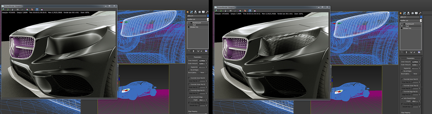

Bug report.
If you apply a Shell modifier to an object. It's no more a smooth object. It's faced.
Please fix it Karba

oguzbir wrote:Bug report.
Please fix it Karba
Cheers
Just tested - smoothing works as expected. Please show your renders.

Karba wrote: Just tested - smoothing works as expected. Please show your renders.
Thanks Karba sorry took your time.
But here I attached what I saw. But after seeing your post I reopened the scene and had a test render with shell on and off. The problem was there.
I tried averaging normals, removed smoothing, nothing. But If I re convert the object to editable poly.
It worked as it should..
Actually I bought this model. And it was in FBX file format. May be some smoothing or normals info was faulty with that.

oguzbir
Posts: 715
Joined: Fri Jun 25, 2010 12:30 am
Karba wrote: could you give me this single object (headlight glass)?
[email protected]
Karba, I just found out that this is a max specific problem..
I still believe this purely because of the fbx file I purchased.
Octane renders just fine.
It's odd but it renders badly same in Scanline. And smoothing gets corrected if object is copied. Funny isnt it :)
The object becomes triangular facet after applying the shell modifier.
If you still want the file anyway. it's attached.
You can see the final render of the car here
http://render.otoy.com/forum/viewtopic.php?f=5&t=42950
You can also see the front window glass of the car has also the same facet problem due to shell modifier.
Thanks again,

Karba
Posts: 2300
[email protected]
Thanks again,
Well, it is not smooth even in 3dsmax viewport.
oguzbir
Posts: 715
Karba wrote: Well, it is not smooth even in 3dsmax viewport.
Well, I guess I replaced max viewport with Octane viewport. :) :)
Somehow didn't bother to check glass object it's not clearly seen in viewport if its assigned a glass material.
So sorry about that really.
Cheers,
