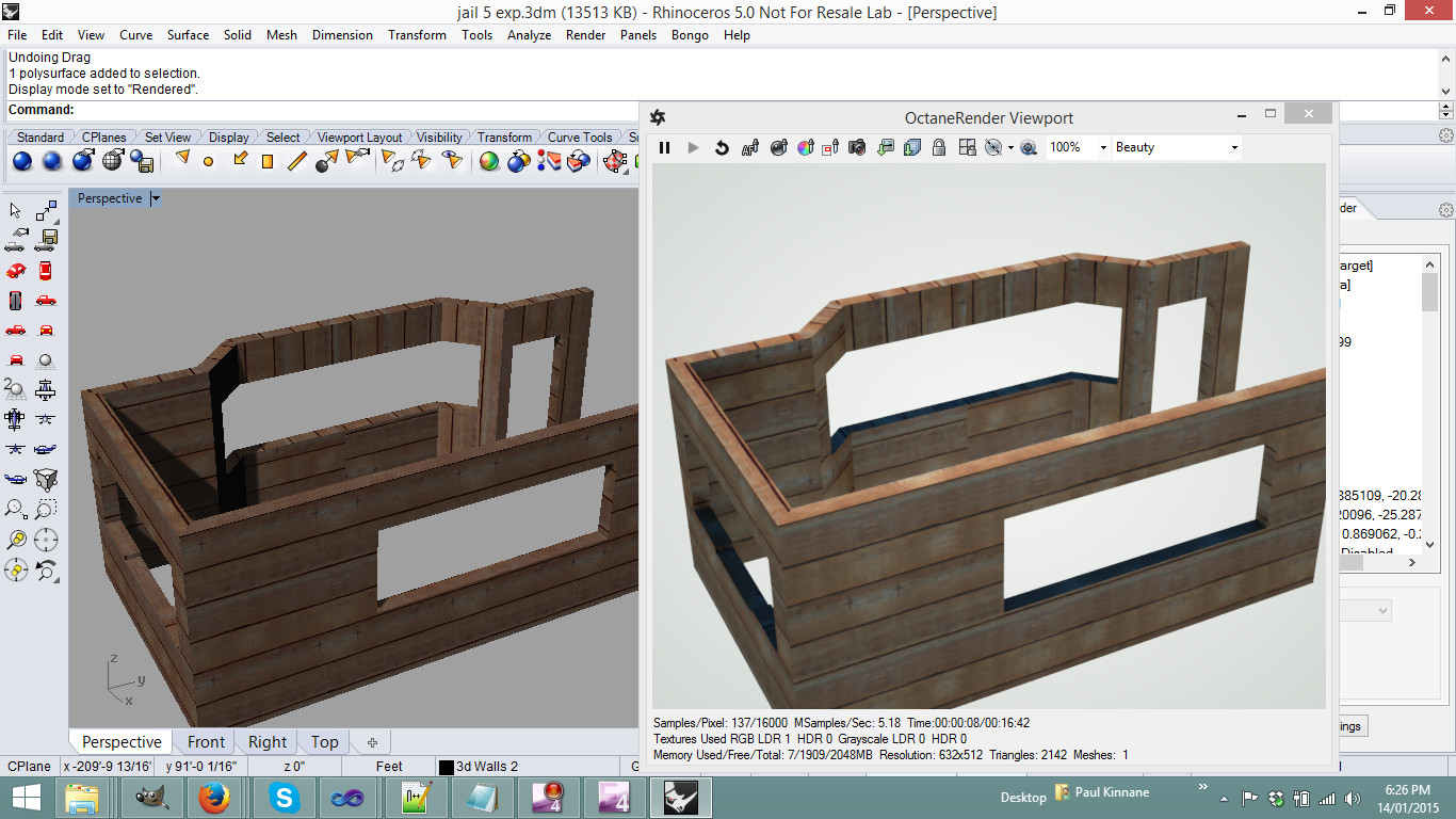

Note that the bricks in your right hand view are standing on end and are quite large. Here, in Octane Render, those bricks are horizontal but in the far, right hand corner of the rendering they stand on end. And in my render the front corner horizontal bricks do not match ... see my prior .jpg file. It does not show the upper rail as it was not drawn yet ... so the whole wall is brick above the windows.
Hi Eric - the texture orientation in the Octane Viewport exactly matches the Rhino viewport. So I think you have a modelling issue.

Hi Paul ..
Yes, I may have a modeling issue.
I created a profile of the wall and then extruded it along a path and then used boolean to cut the openings to create a single solid result.
I don't understand how or when or why the brick pattern is not consistent. Obviously the faces in question are oriented incorrectly but it is one solid object.
I'll model this wall again in another part of the overall drawing and see if I get different results.

Well, I have rebuilt that wall using a number of different alternative methods and I have also tried Otay materials brick as alternative.
In every case some wall surfaces have the bricks running horizontally and some vertically. Can't be changed.
I don't think modeling errors are involved here .. all are closed solids and essentially single pieces. I did not cut openings into these experiments.

Hi Eric
The issue is that whatever modelling technique you are using....is it not assigning UV coordinates correctly. The Rhino preview window shows the UV's are incorrect too - is it problem is unrelated to the Octane plugin.
To fix it....select the model for the walls (in the 3d Walls 2 layer), go to Properties tab, Texture Mapping, Apply Box Mapping, draw a box around the geometry. That will fix the incorrect UV Coords.

Thanks Paul ...
Now it works like a dream.
