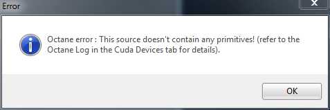

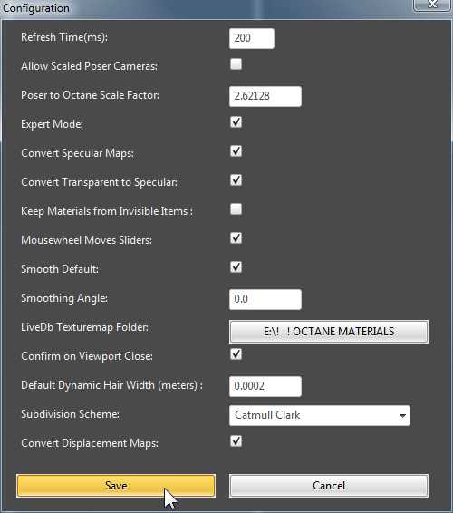

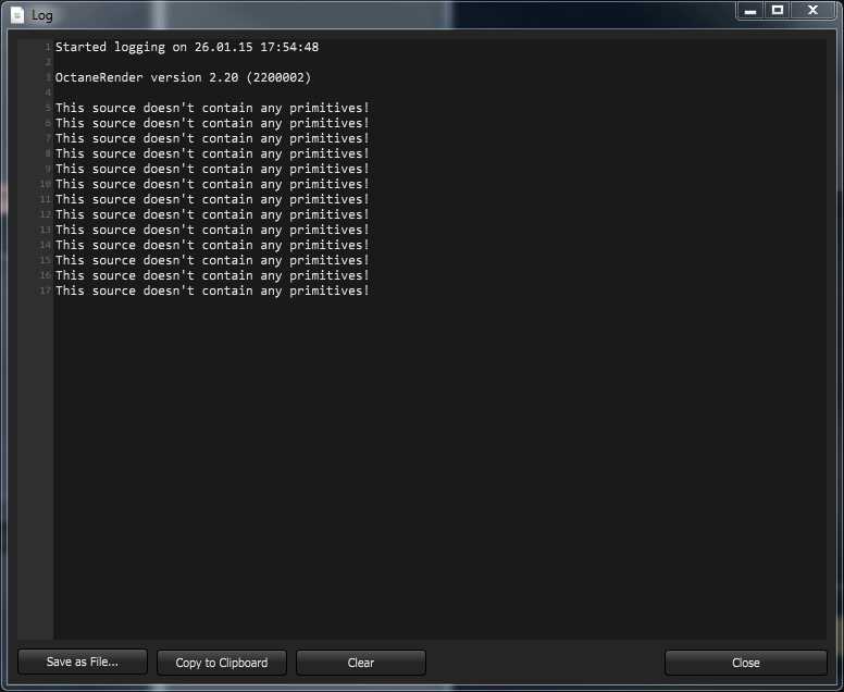

This....
First set "Convert Displacement Maps" to checked
Load prop
Errors....

Deane - what release of the plugin are you running?
Paul

2.20.0.39
If you reconvert all materials from Poser using that release of the plugin, it will stop those errors from occurring on that scene. And I believe that the next release of Octane will also suppress that log message. It is caused by Poser props having a negative displacement.
