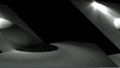

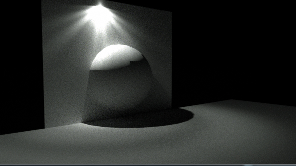

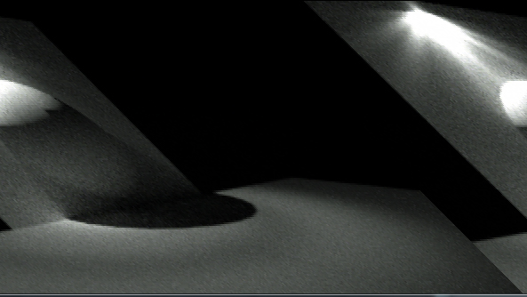

There's another glitch with IPR and I've noticed this since 2.0.0 Sometimes get a kind of skewing in the IPR window when set to half rez with fixed aspect also checked. Seems to happen on any scene simple or complex but I can post my sample scene if you like.

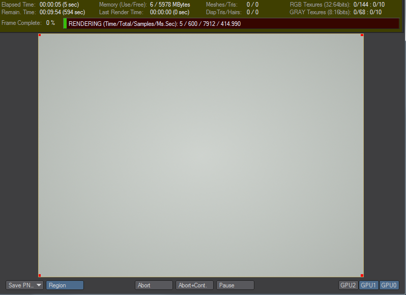

I'm having a problem with the region render even working at all. Every time I turn it on whether or not I have Limited Region render on all it does is go to max size and refuse to adjust. This happens even in complete empty scenes with nothing in them with a fresh reboot of lightwave 11.6.2. I'm wondering what I'm doing wrong.

Draydin_r wrote:I'm having a problem with the region render even working at all. Every time I turn it on whether or not I have Limited Region render on all it does is go to max size and refuse to adjust. This happens even in complete empty scenes with nothing in them with a fresh reboot of lightwave 11.6.2. I'm wondering what I'm doing wrong.
Control click selecting not working?
