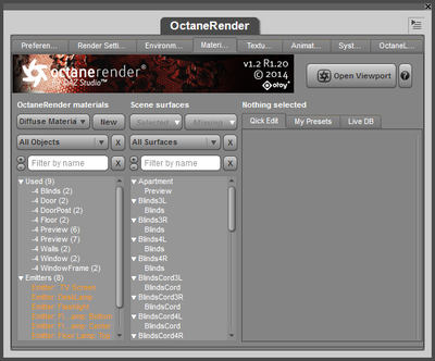

vortex3d wrote:I thought the Emitters were fine in the "Used" group with the rest of the mats.
the idea was to quickly find light emitting materials in a scene without the need to give them a particular names, to speed up tuning the scene lighting. i think this is the case, but the colors, well; i may skip the additional "active" inking if the colors are identical...
Absolutely. I just hope it stays consistent with the rest of the mats.

The "Automatic material updates after content loads" option is adding negative numbers next to the each related material with every change.
So far this feature strips Octane materials upon related surface changes in DS. :o

vortex3d wrote:The "Automatic material updates after content loads" option is adding negative numbers next to the each related material with every change.
should be both fixed now (the latter was somehow connected with the multiplying mat issue).
