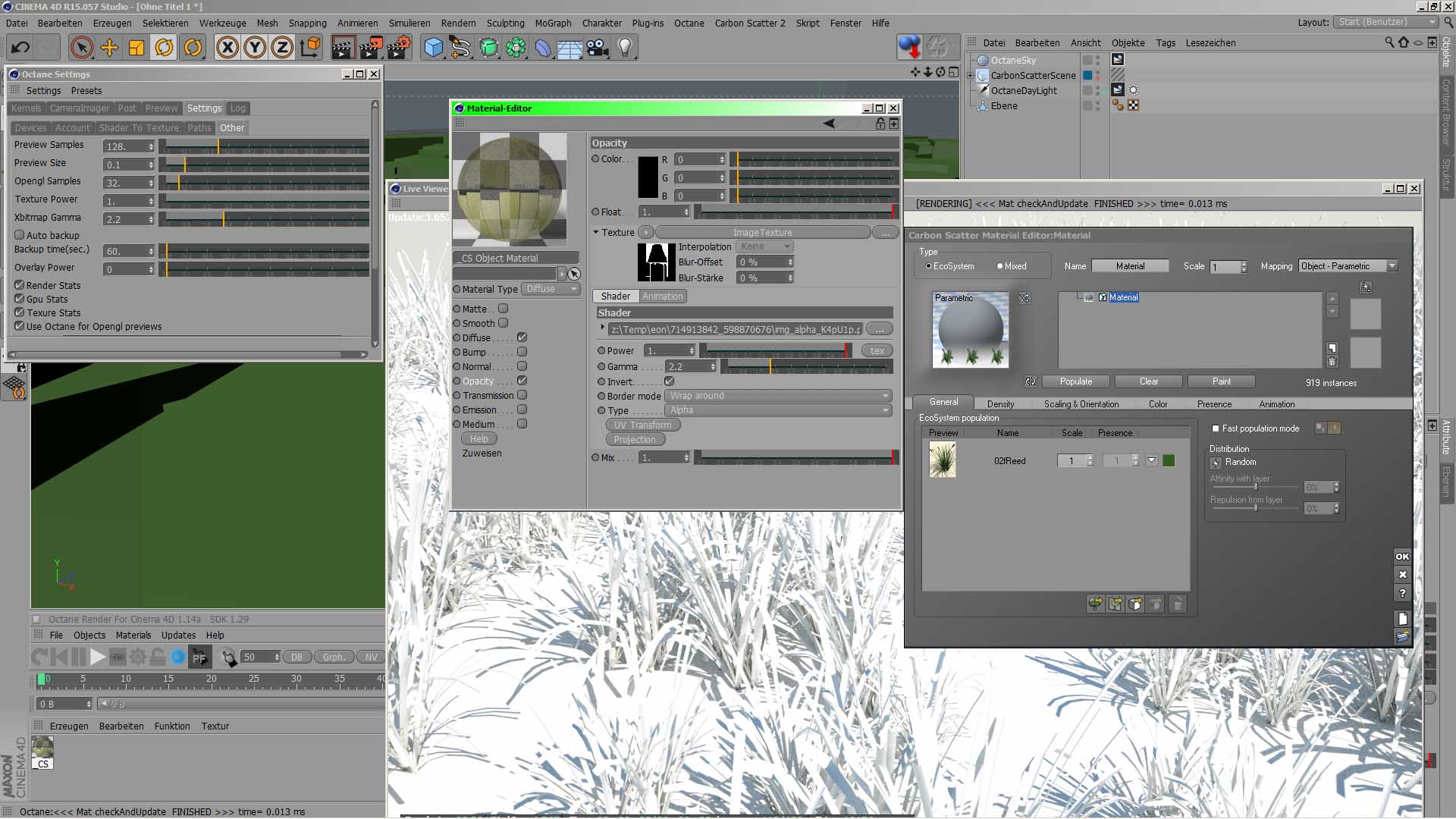

Hello aoktar,
the models made from carbon scatter 2 can be not more colour.
No matter whether the alpha channel is inverted or not.
The models are always as shown on the screenshot, white.
NVN
Posts: 504
Joined: Tue Jun 08, 2010 8:10 pm
your filetyp for alpha is alpha.
Turn it to "normal"

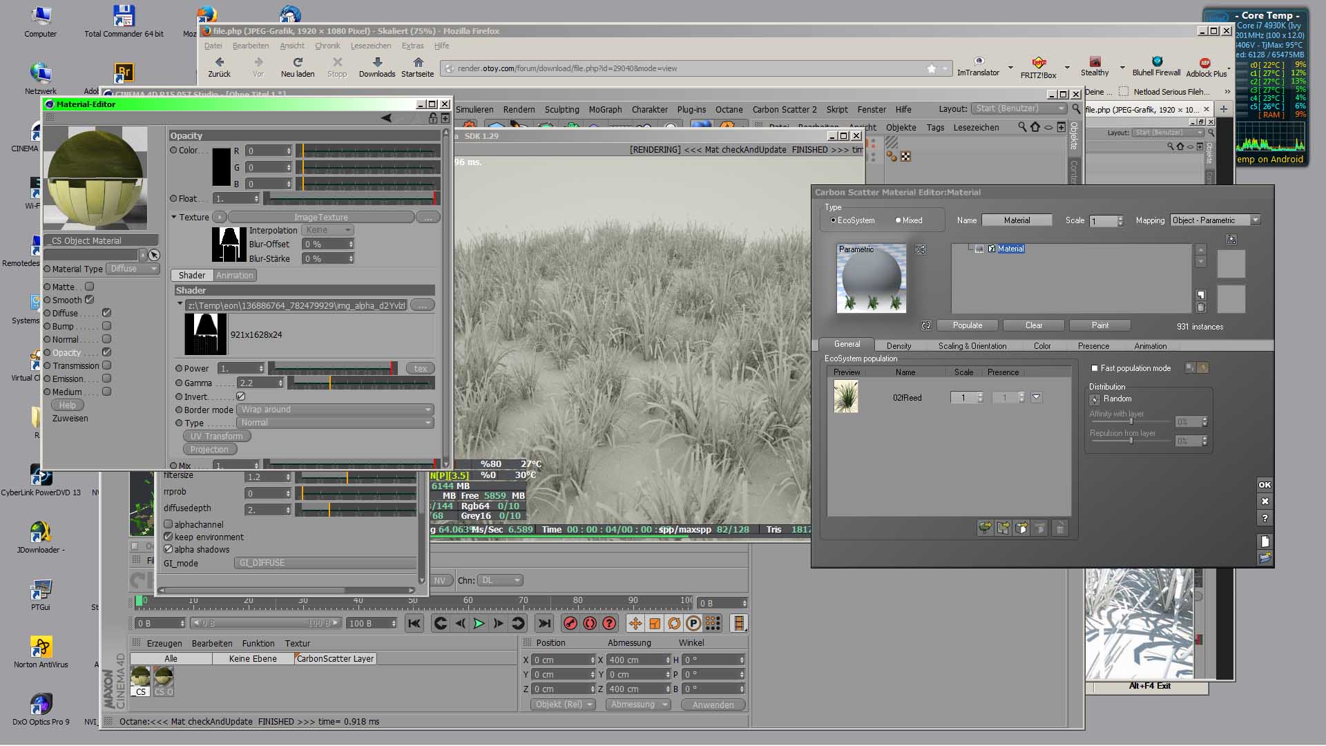

I tried everything already.The carbon scatter 2 objects no longer go. You are also only still white. It lacks the color, the texture..
Posts: 16068
Location: Türkiye
Rudi,
pls check console output for missing textures?

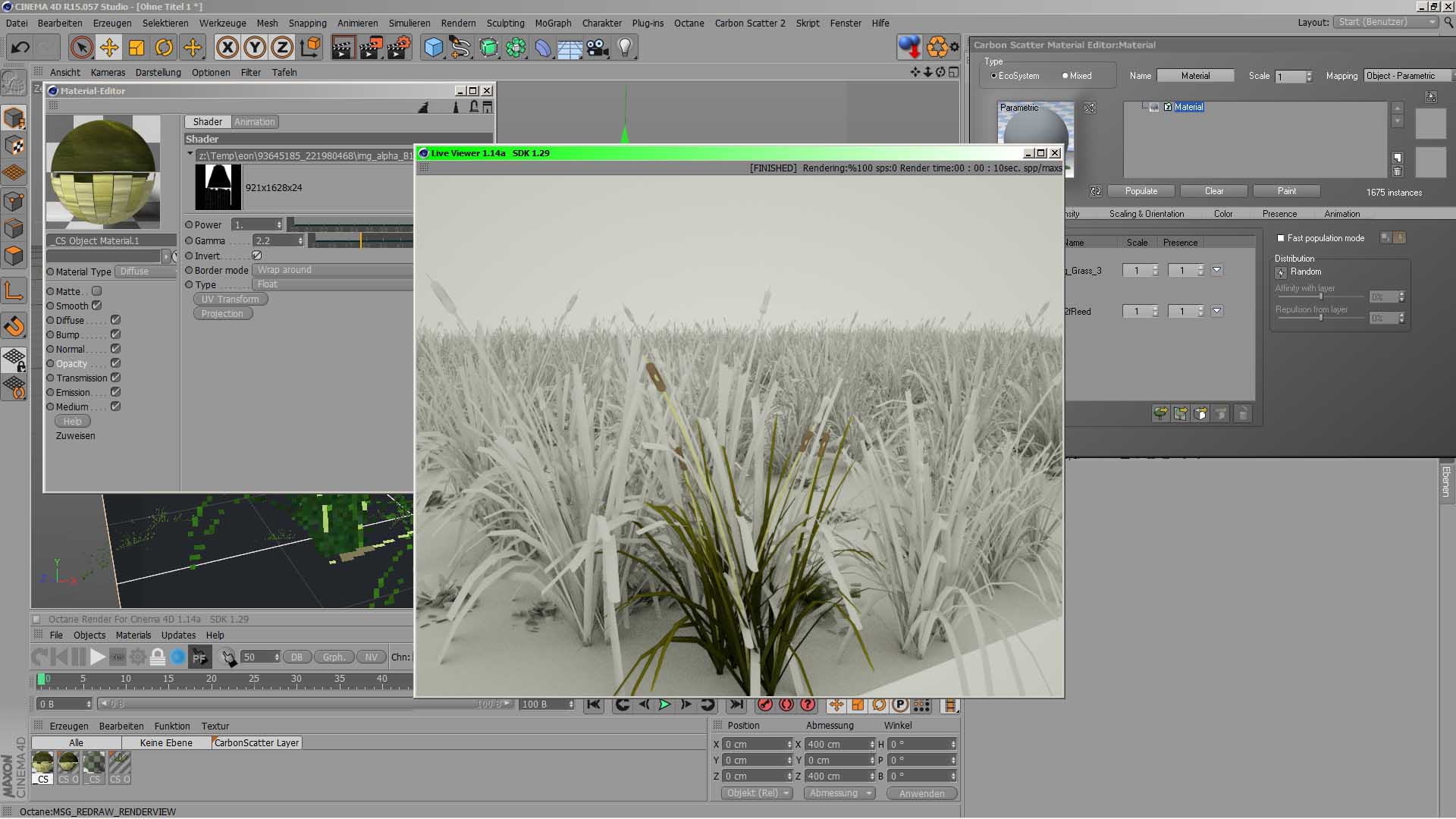

The original can be seen in color. But isn't the alpha and it is semi transparent. Texture power under settings is 1. Die copies are only white.
No matter what I do, nothing changes.
The logfile is attached
octane 1.29 140212 153231.log
(3.13 KiB) Downloaded 238 times

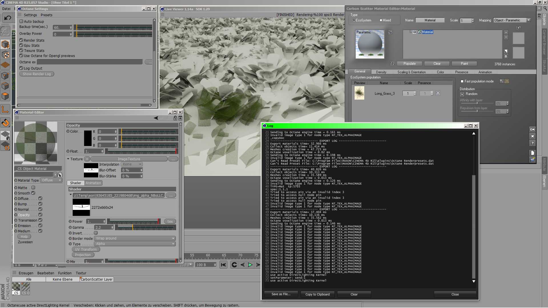

Opacity -> Invert hooks in -> Type-> Float
Textures are in order and obviously.
But all copies are colorless furthermore.
But Invert on or out brings other textures obviously. :o

you are right, Carbon scatter didnt work anymore....
Maybe Aoktar can help us?
Coloring will be ignored
edit: but only by the Vue Objects.Native Instancing will work
