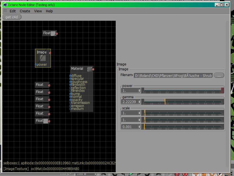

What must I set where, to see the connecting lines. With me, you are black as the background.
Posts: 16063
Location: Türkiye
@RUDI: lines must not seem as black. What is your c4d version?
Rudi
Posts: 188
Joined: Sun Sep 01, 2013 7:05 pm
aoktar wrote:@RUDI: lines must not seem as black. What is your c4d version?
R14 and R15.

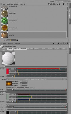

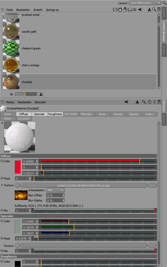

Own material is not partially read in, although it is properly indicated in the library (LIB4D).
Here chocolat.
I also have to read in no possibility the texture about paths anew, because it is in the lib4d file.
Under R14, but R15 is the same.
White, not chocolat
White, not chocolat
Crazy, the other Material in this List are okay.
