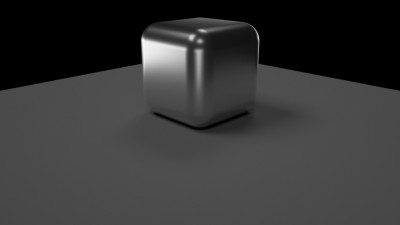

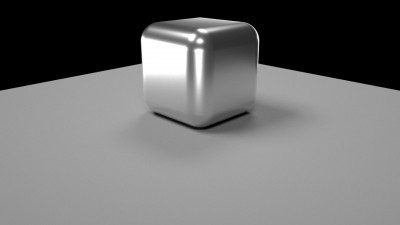

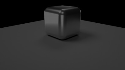

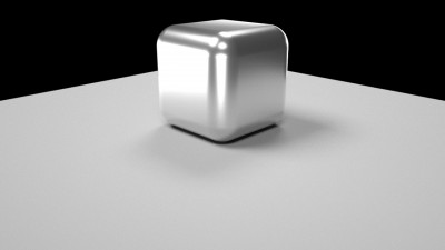

Could you make it possible to save Untonemapped Pictures within the C4D Rendersettings Save dialog?
I have a problem there, when it comes to HDRI Images with values going above white.
Example:
1st Image:
Live Viewer save Dialog "Save as exr image..."
2nd Image:
Live Viewer save Dialog "Save as exr image..." Exposure dialed down 3 stops in PS with the "Exposure" correction (Notice there is no information loss in the highlights)
3rd Image:
Saved through C4D save dialog (Renderd via the "Picture Viewer" as .exr) (Looks [about] the same as 1st Image)
4th Image:
Saved through C4D save dialog (Renderd via the "Picture Viewer" as .exr) Exposure dialed down 3 stops in PS (It has been tonemapped [clipped all above white information] so no highlight information is kept (results in dull to dark highlights like in an 8bit Picture).
Notice:
Of course I have converted the .exr´s to .jpg images for presentation purposes. I converted them after I processed the full 32bit EXR´s so no information was lost!
Please can you introduce a option where it is possible to save out untonemapped images through C4D?
Why?
This is important for compositing thus I get more realistic glow, motion blur, blur and dof (if i do it in post) due to the above white info that represents reality much better then a clipped to white footage!
Cheers,
Raphael
