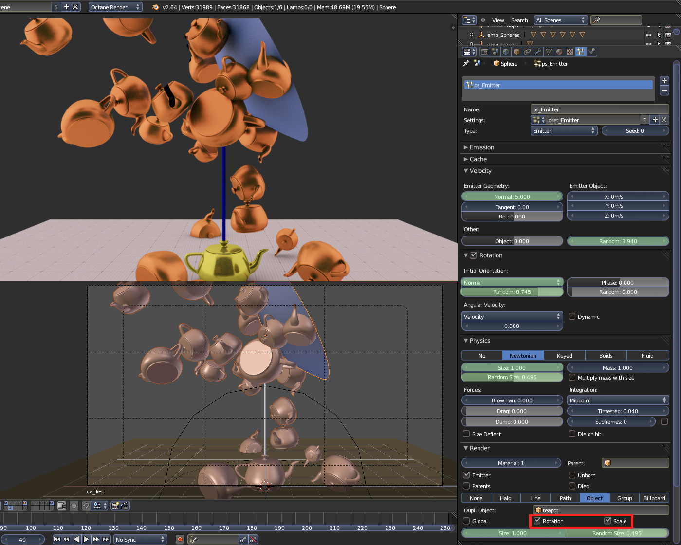

0.1.9 Update (download at first post)
* Emitter PS rotation / location / scale now works correctly (for the supported settings at least)
* Particles hidden for viewport ("display" parameter) are still exported
Depending if the PS is hair or emitter, you must treat particle location / scale / rotation differently, that's why the previous code that worked for hair, messed emitter PS entirely. In the above example the settings in green are the one I tested and work ok. Note that you must have checked the settings circled in red.

Yep, all works now perfectly. I'm happy. :D

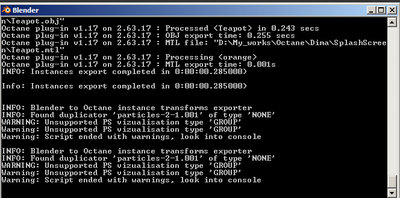

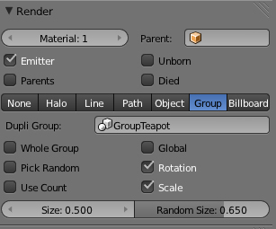

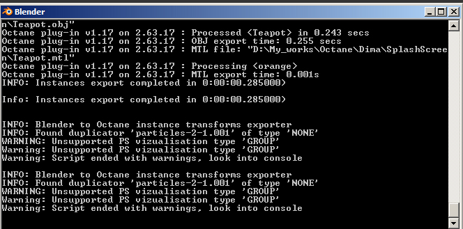

Found another problem. If source of particles are group of object, script could not create .csv file. In console i see that the problem is in the type of visualization mode, that i choose as "Groupe".

It says there in the log (and on the first page :) ): groups are not supported, only object visualization (atm, because of Python API limitations)
