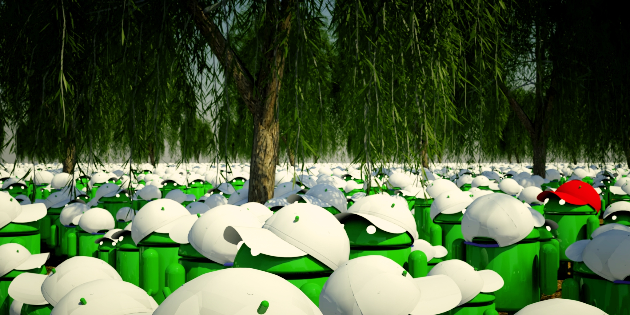

Did this scattering with over 16.000 androids and a tree scattered a few times with help of an excell matrix.
Rendered just 320 s/px with directlighting and daylight.
Just a tiny postwork tonemapping.
greetings

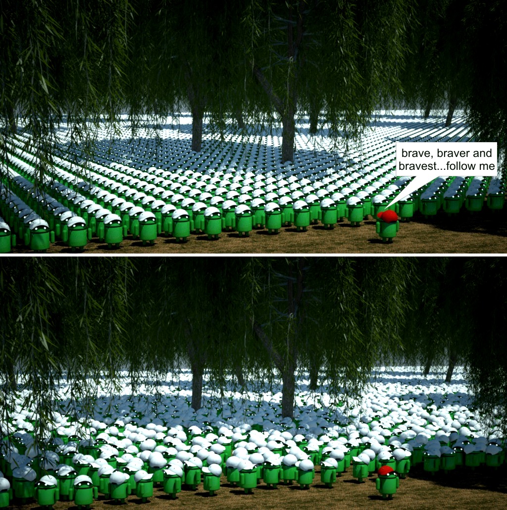

Playing around with scattering using an excel sheet and trying to optimize the sheet...
..."matrix and de-matrix" :mrgreen:
