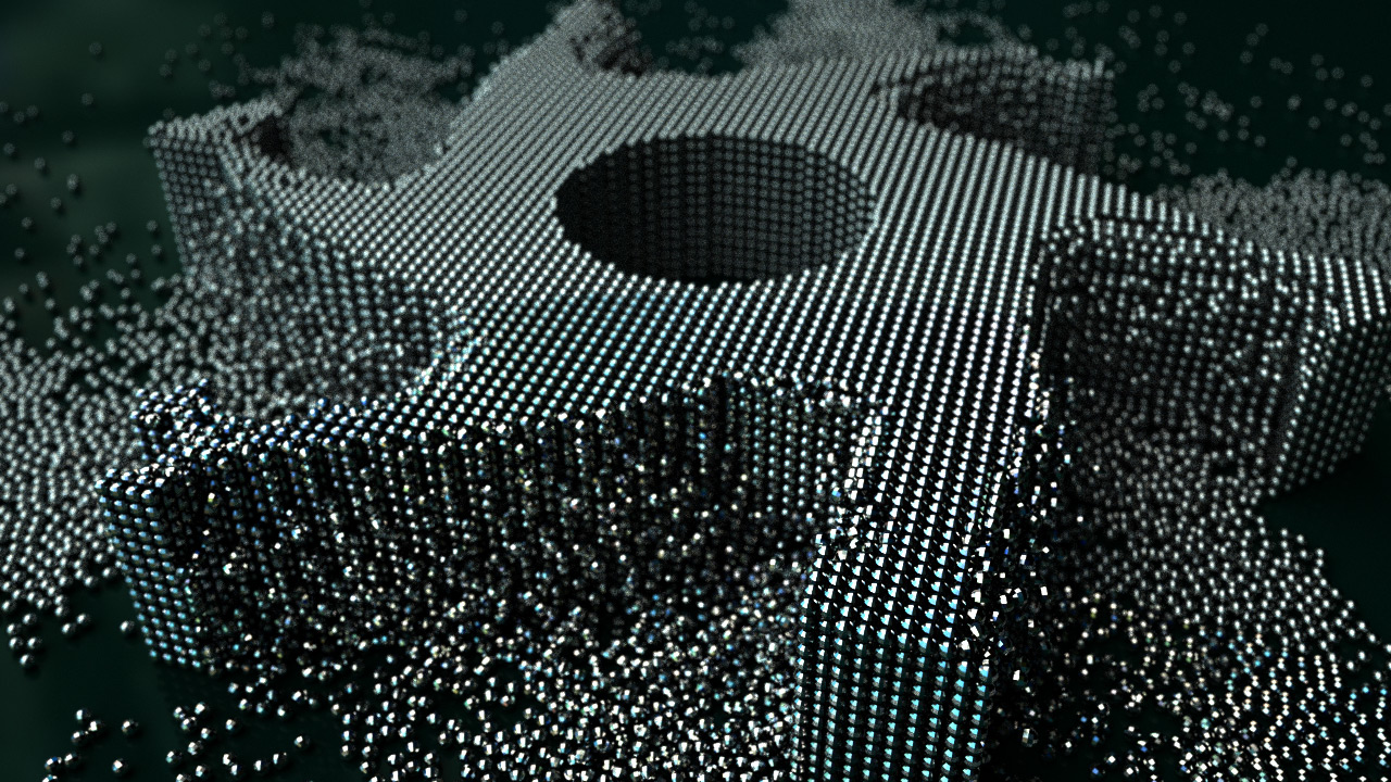

Here the hires version with more boxes...
Now i must replace each box with a character ;)

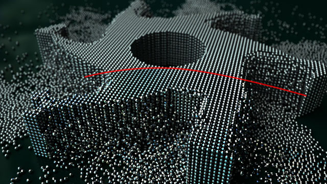

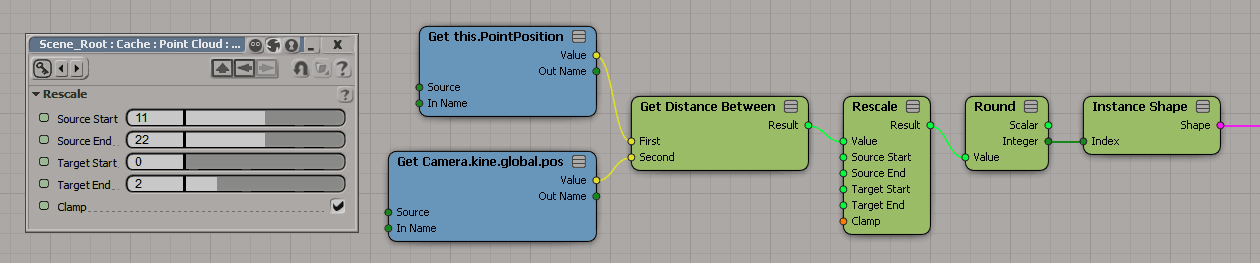

There are two tricks. Only 1,5mio tris.
First trick is to remove spheres with more then 26 neighbors. That removes the inner ones and change the number of spheres from 50000 to 27000, depending on the complexity of the current frame.
Second trick is to change the level of detail with the distance. With 3 levels, for the current frame i come from 6.5mio to 1.5mio tris...

face
Posts: 3204
Location: Germany
mlody47 wrote:
face wrote:Second trick is to change the level of detail with the distance
+1
You managed it in ICE??
Thats correct.
As instanceShape i use a group.
The problem is to get a nice flow. In the image you can see the hard edge between two levels.
To solve that, you can use a turbulice around value after the rescale, to break the edge a little up.
