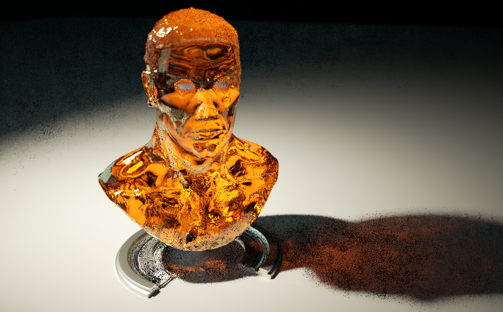

I'm having a problem. I thought I would give the latest build a whirl and see what changed with my old head-bust render. But I've been getting these black fireflies... Any one know whats up?

Just Discovered that thes black fireflies are connected to the exploration depth. A value of between 0.98 and 1 creates them and from 0.97 down works fine....
Could some one help me with this one? It's alitte confusing :)

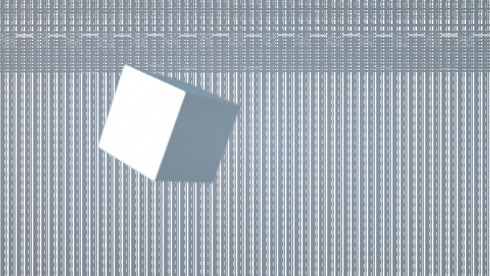

it seems t o be a bug with alpha channel ( the first exported render alpha is bad, glotchy but it become ok after a camera mouvment )
I just tried to reproduce this problem, but couldn't. Is there anything special I have to do? Could you maybe post/send us an example scene? Which 3D app and graphics cards did you use?

it seems to be a bug with alpha channel ( the first exported render alpha is bad, glotchy but it become ok after a camera mouvment )
I just had this exact problem.
had to render a scene using the old 2.46 version in stead What a shame. I really like this new version. :(
I had to render a animation therefore could not move the camera in every frame. When is this expected to be solved?
As I couldn't reproduce the problem, could you please send us or post an example scene (the C4D file would be best, if it was a C4D project)? I couldn't reproduce it here.
Thanks,
Marcus

Draydin_r wrote:Just Discovered that thes black fireflies are connected to the exploration depth. A value of between 0.98 and 1 creates them and from 0.97 down works fine....
Settings close to 1.0 are currently broken, we will fix that in the next release.
Roeland

abstrax wrote: As I couldn't reproduce the problem, could you please send us or post an example scene
Hi Marcus

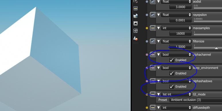

here is a (very basic) animation file created with blender 2.59 ( exporter from lionnel v1.10 ) but i tried animations with lightwave too, and there is exactly the same problem. If you launch the animation computing, after look at rendered pictures with the default windows picture viewer and ( i hope :) ) you will see the glitchy alpha around the cube...
I'm working with Win7, 64bits, 2 x GTX 470 drivers nvidia 280whql .I experimented no other big problems with this 2.49b...
ps:
except alpha settings, all octane parameters are inital ones
octablend.zip
(103.39 KiB) Downloaded 225 times

Thanks for the feedback on the alpha channel issue: There seems to be a problem with the very latest NVIDIA graphics driver for Windows 280.26. I'm currently investigating and check if there is a hidden problem in Octane, but for now just make a clean update to the previous stable driver 275.33.

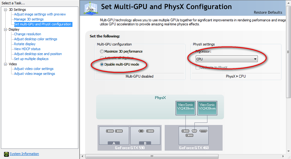

Yesterday we also found some strange issues regarding available memory in single-GPU and multi-GPU modes. It turned out that the multi-GPU options in the NVIDIA control panel was the culprit. -> To maximize your available graphics memory for Octane on Windows
- make sure that Windows Aero is disabled
- make sure that multi-GPU is disabled and to be on the safe side also disable PhysX:
Cheers,
