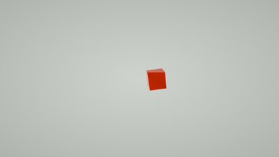

Hi abstrax (Marcus), i attached the cube as an image in this attachements. You can see that one edge is not parallel with the other edges.
If i try to render a sphere, then octane crashes with the error message: 'ERROR: Program executed illegal instruction.. terminating'. With this error message i cannot find out the error. Octane has no proper error handling. I strongly recomment to create a trace version of octane to find out the code position where it crashes. Perhaps i can do it for you because i am a C++ programmer. If you do this, then you will find the problems faster and you have less support times. You will the winner of this method, and we are the winner because we can work: win to win! To do this is easy.
