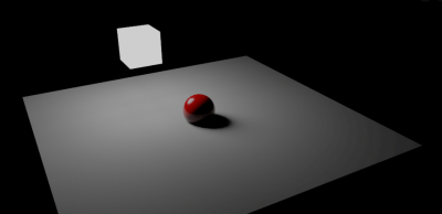

animani wrote:Hey, guys just testing this out and all I get is darkness. Everything is black. It seems to be rendering whatsoever. Added environments, lights, added materials just in case but no luck.
Does it work in preview?
Can you share more info how your scene was set up or maybe upload it?

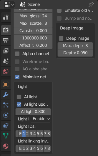

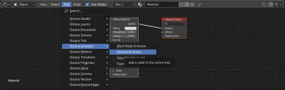

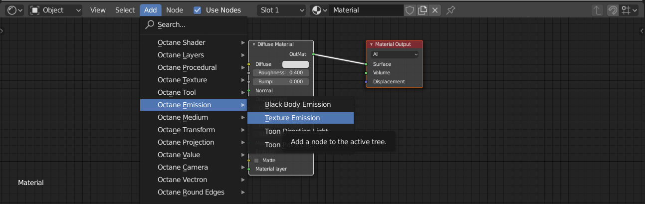

Hi Animani,
Octane doesn't use Blender lights, but rather an object with and emitter attached.
Create an object and give it a new material. I usually give it a Diffuse material.
Go to the Shading layout and then add a Texture Emission node.
Notice that the Light pass ID in my image is "1".
Next, go back to the Renderer and set the following:
Light ID Action: Enable
Light ID: Turn on "1" or whatever matching numbers to the light\objects in the scene.
Note: "E" would be if you added an environment light.
Of course, make sure "Viewport" shading is set.
Hoping others chime in so that I can see if there are other ways to light the scene aside from using the environment.

gfxrtist wrote: ..
You don't need to do that. By default all light emitters, environment and sun are enabled. The settings in kernel are useful if you want to disable or enable specific lights or environment.
There is also a setting in Object data – "Light pass mask". This is useful when you want to exclude a specific object from being lit by a specific light.

Hi J.C,
This is true, but sometimes I don't want the environment to affect my rendering, only the light sources.
I'm going to check out what you suggested to see if this helps.
Thanks!
(EDIT)
So It looks like I don't have to enable that option. I can simply turn off the lights by selecting the ID numbers. Almost the opposite effect of enabling the option.

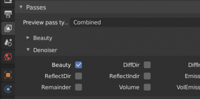

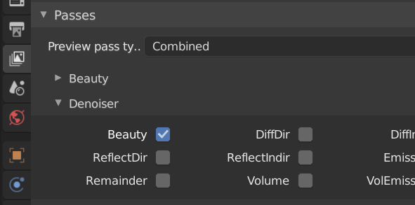

ubuchy wrote:Hello,
Does anybody know how to make the denoiser work for regular F12 render? I managed to get it work for the preview. But for the regular render I dunno what I'm doing wrong.
You have to enable the Denoiser Beauty pass in the render layer/pass settings, and then use that pass.
Windows 10 Pro - AMD Ryzen 7 2100X 8 core 3.70GHz - 32GB RAM - GeForce GTX 1080 8GB
