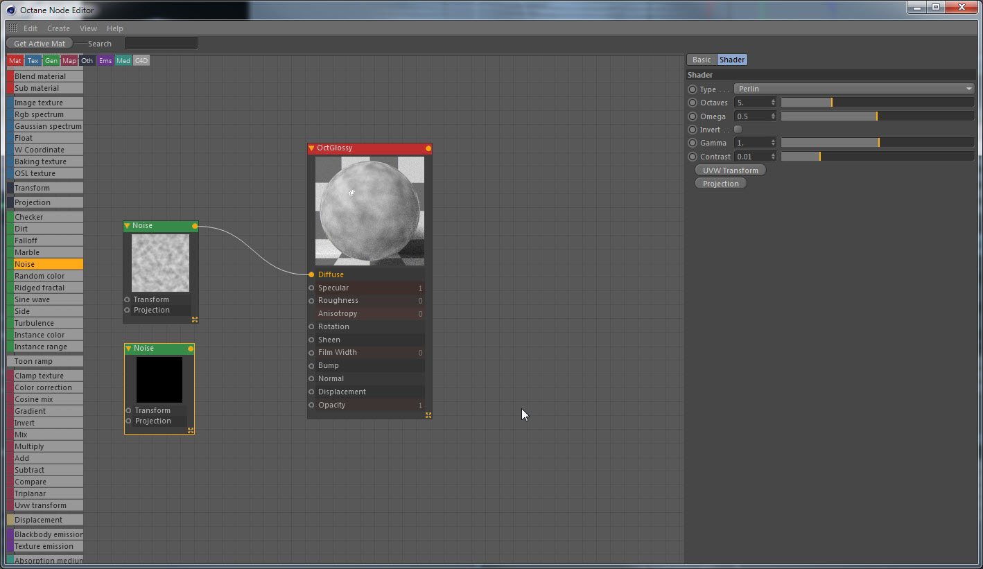

All is better now with R20, no crashes so far on few small scenes! Its faster overall! One question, is this possible to have random color on this setup?
link: https://www.dropbox.com/s/olaf1xckdgqop ... e.c4d?dl=0
Thanks!
