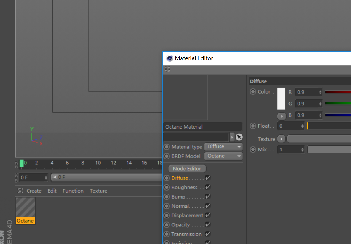

Why materialpreview do not display? I used R18.057 ,NVIDIA 391.01

kid1990 wrote:Why materialpreview do not display? I used R18.057 ,NVIDIA 391.01
Please explain it better! There's working well.

materialpreview do not display,
Double clicking can not be shown

kid1990 wrote:materialpreview do not display,
You may have wrong plugin files. Also check Console window for loaded dlls and check if matches your license type.

Posts: 4
Joined: Tue Mar 22, 2016 4:35 pm
I reloaded octane, and I delete license type, or I can't
